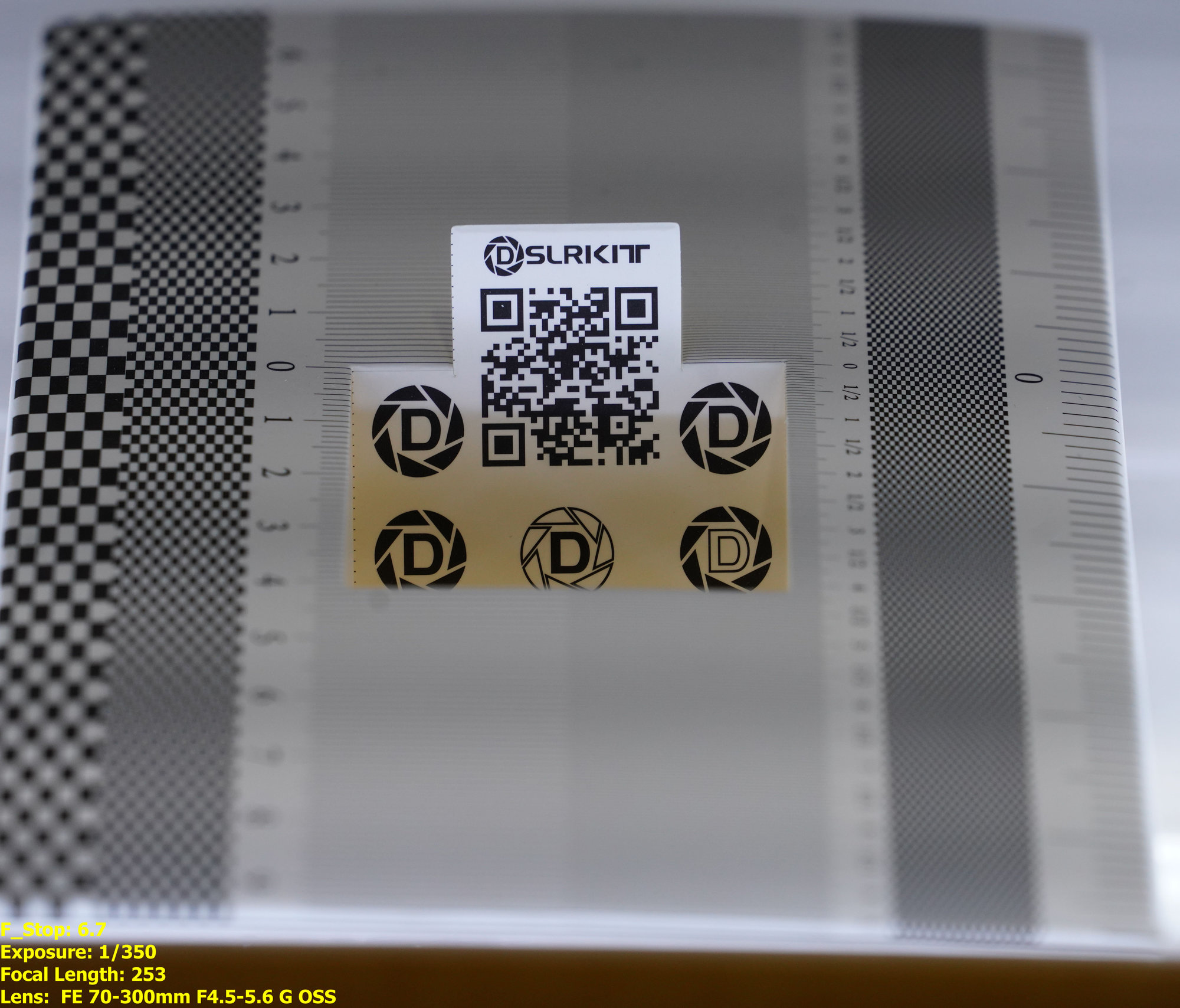

Re: label an image with data from EXIF
Thanks Pierre:
That works. I was also able to add in {Lens Model}
I ended up putting each value on one line: that seemed to be more successful.
I think the difference here is that I was using EXIF codes from the internet; the ones I found didn't have any spaces. However in XNView the codes do have spaces, and this suggestion uses the codes that I see in XNView. Whether this is an XNView quirk or something more broadly based I don't know but the outcome is good anyway.
Image attached. Might be useful to put in the ISO value as well.
Richard
