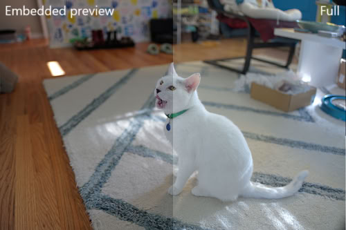

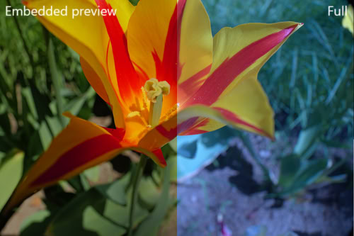

DNGs from Leica Q3 do not look right at full size
to reproduce:
1. change default settings
- change 'Camera RAW, use' from 'Embedded preview' to 'Full'
- (optional) disable Color management
2. open test files:
Related
Posts: 47727
Re: 1.8.6 - view - camera raw - dng - issue with Full size
you can use 'use embedded color matrix' & 'use automatic white balance'
Posts: 2912
ok, 'Use Automatic white balance' is responsible for color shift,
but shouldn't it be unchecked by default to provide a quality close to 'As Shot'?
