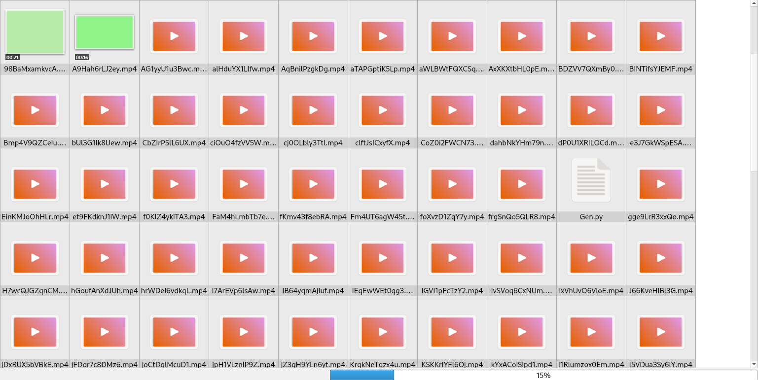

Here in this screenshot, in another instance, the video that crashes it is "AG1yyU1...". It's a random video each time, after about 15 or so thumbnail generations.
Since I can't upload an entire video folder, I used ChatGPT to make this code to generate random videos, which are used in this test case (100% reproducible on Linux with video thumbnails turned on)
