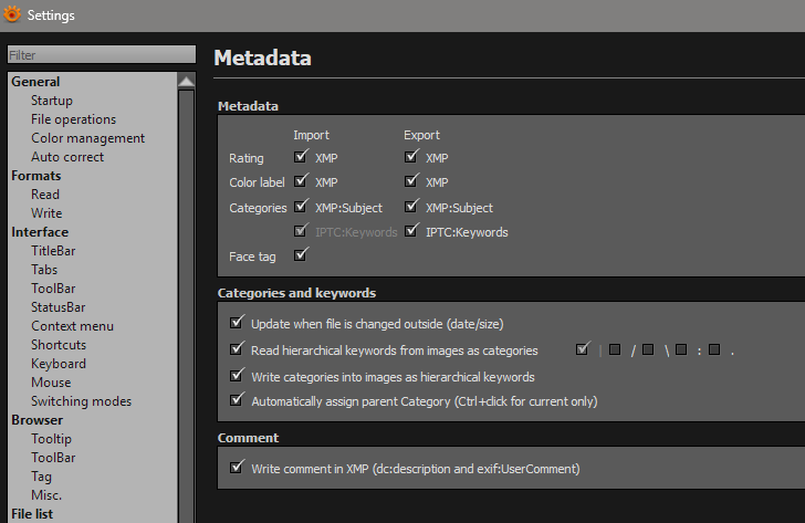

Case 1: The category is already known in XnViewMP and created hierarchically (Photography|Plants|Tree). The category was stored exactly in the tool and assigned to the RAW/JPG file. Although the corresponding settings were made in the XnViewMP setup (automatic parent category), only the category “Tree” is imported, but not the parent structure.
Case 2: The category is not known in XnViewMP. The category was created in the tool (Photography|Plants|Flower) and assigned to the RAW/JPG file. During import, a new category “Flower” is created in XnViewMP, but not under the existing structure Photography|Plants| but under a new structure Plants|. The topmost structure “Photography” was not taken into account.

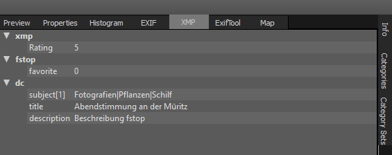

When I look at the file info, I see the category I entered under xmp, dc, subject[1].

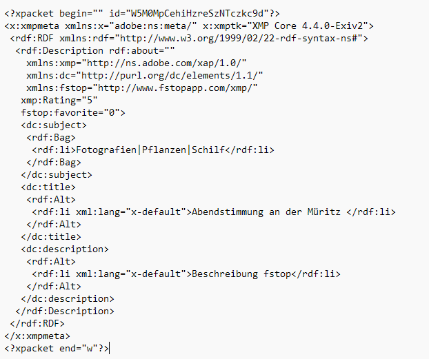

In the RAW/JPG files associated sidecar files (.xmp) my categories are entered as follows:
<dc:subject>
<rdf:Bag>
<rdf:li>Photographs|Plants|Tree
</rdf:Bag>
</dc:subject>
What do I have to do so that the categories assigned to the photos, including the default parent category, are correctly adopted by XnViewMP?
