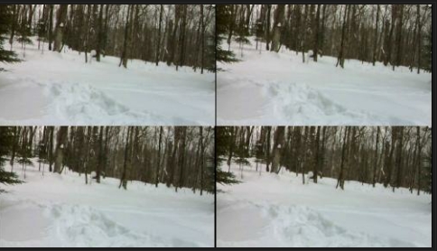

Ok, I have generated a log file. I tried to attach it here, but it wouldn't accept a .txt file. Please let me know how to send it to you.
By the way, I don't know if it is related, but the thumbnails for my videos always show a 2x2 grid of an image. I have attached an image showing what I mean.

Re: 1.8.8: video playback broken since 1.8.7
Yes. For me, 1.8.6 works and all of 1.8.7, 1.8.8, 1.9.0 all fail. And I'm on Ubuntu 22.04. So I think @aucora's issue is something different.xnview wrote: Wed May 28, 2025 6:08 amand in 1.8.6, all is correct?dchristensen wrote: Tue May 27, 2025 6:14 pm For the record, I just tested 1.9.0, and still have the same issue.
