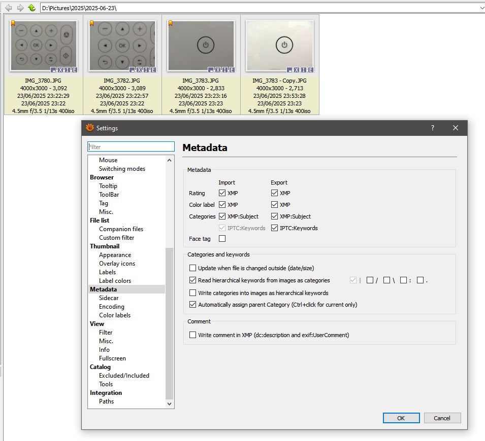

I have the options set to Write Categories into IPTC and XMP. Settings > Metdata.

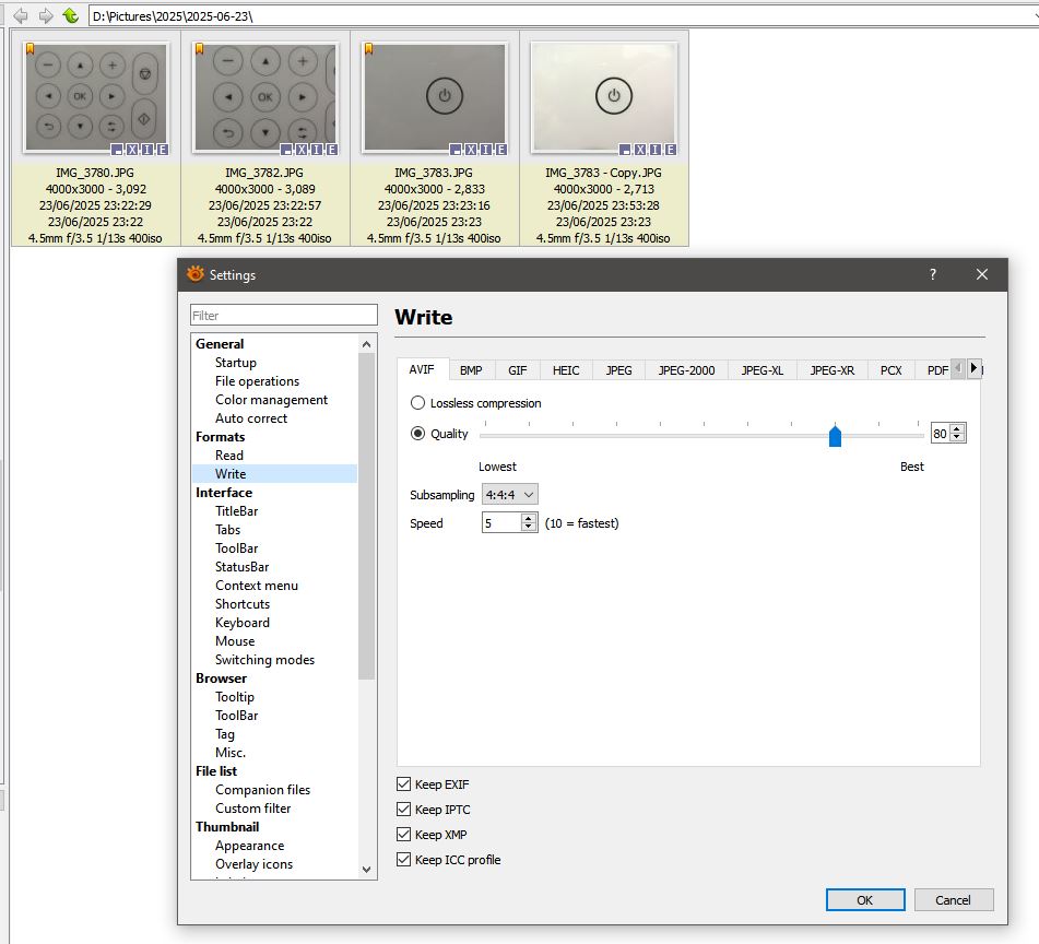

I have the options selected to Keep EXIF, IPTC and XMP when saving. Settings > Formats > Write.

My default view has the Categories panel open. The Category is not selected for the saved image. Also the saved image does not have the little symbol on it's thumbnail. If I do Metadata > Update catalogue from files on the saved image the Category becomes selected and the symbol appears on it's icon. Do I have to do this every time or is there a setting to have the Categories automatically selected after editing and saving images?

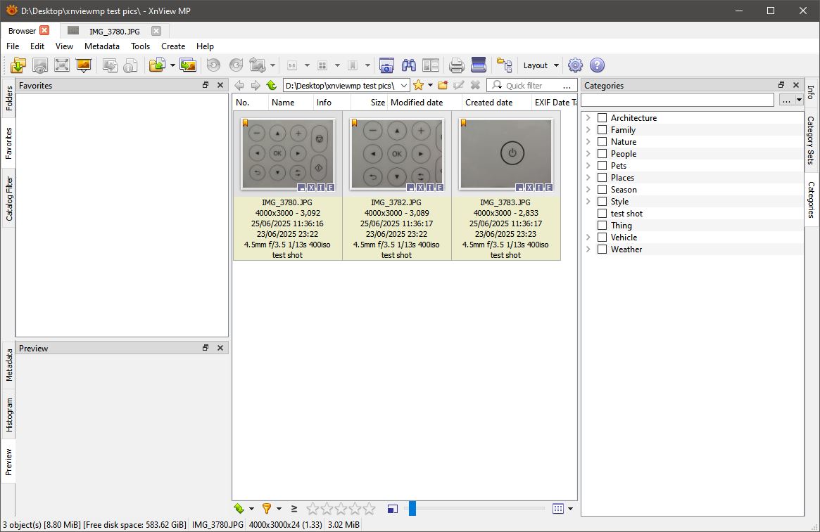

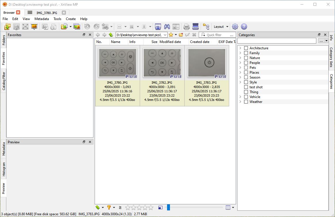

Thank you Pierre. Sorry I made a mistake. The metadata is in IPTC and XMP but the saved image does not have the Category selected in the Categories panel and the thumbnail of the saved image does not have the Has Category Overlay icon on it.
I have to do Metadata > Update catalogue from files to make the Category become selected in the Categories panel and the Has Category Overlay icon appear on the thumbnail. Should I have to do Metadata > Update catalogue from files? I thought that after saving an image that already had a Category assigned the resulting saved image would also have a Category assigned and have the Has Category Overlay icon on the thumbnail.

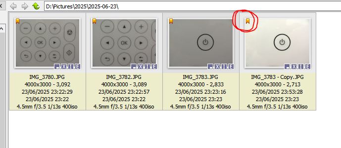

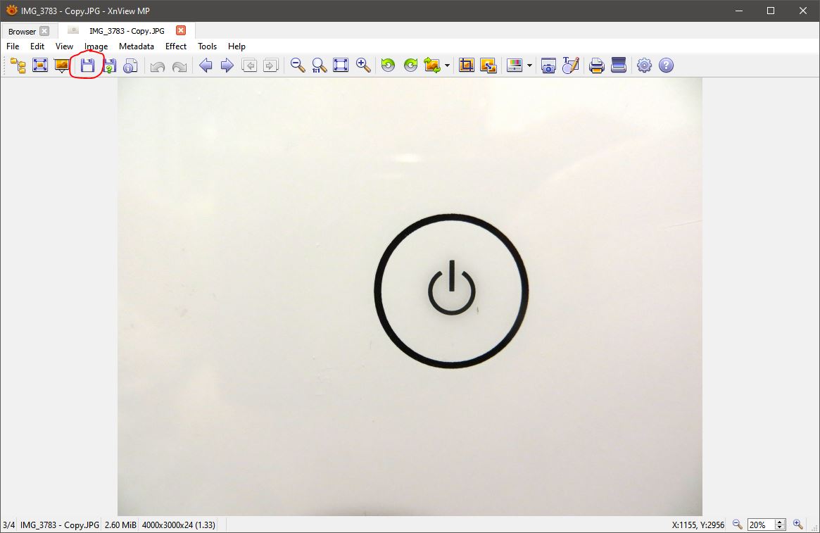

Here are the steps I take.
1. Import images. 2. Add Categories. 3. Overlay icons have been added and the Category is checked in the Category panel. 4. Double click to open Image and then edit it. 5. Click Save to Save a copy. 6. Return to Browser. Category is not checked and the Overlay icon is missing.

ok, thanks, i can reproduce with 'Save as' & 'Save copy'. 'Save' will overwrite the file and keep overlay.
