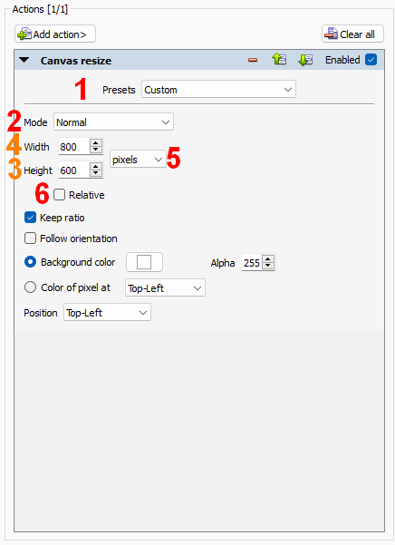

I'd like to report a very minor bug (or perhaps an inconsistency) in one of the actions I frequently use: "Canvas resize"
The action itself works correctly, but there's an inconsistency in the tab order of the input fields depending on the selected value type.

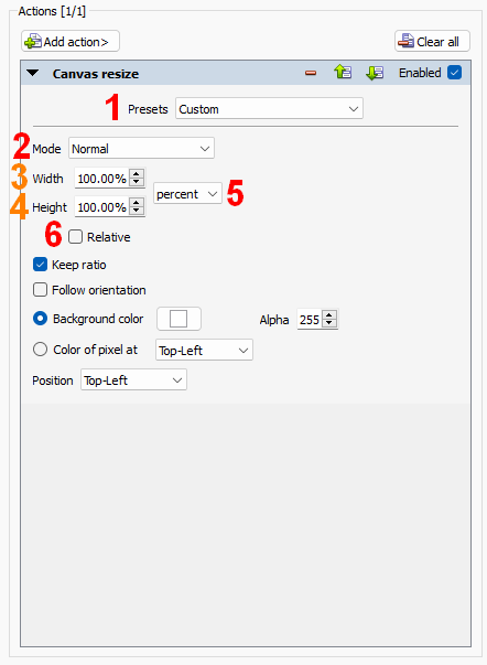

When the value type is set to "percent", and I type a number into the "Width" field, then press the Tab key, the selection correctly moves to the "Height" field - which is the expected behavior (at least for me).

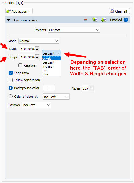

However, when the value type is changed to any other option (pixels, inches, cm, or mm), pressing Tab from the "Width" field moves the selection to the value type dropdown instead of the "Height" field. Interestingly, pressing Tab from the "Height" field then takes the focus back to the "Width" field.
In other words, the tab order of the input fields changes based on the selected value type, which can be a bit confusing during keyboard-based input.
I've attached annotated screenshots that illustrate the tab order in both cases. I hope this explanation is clear and helps improve the experience for keyboard users.

Re: Minor bug report - "Canvas resize" Tab order inconsistency
right :bugconfirmed:
