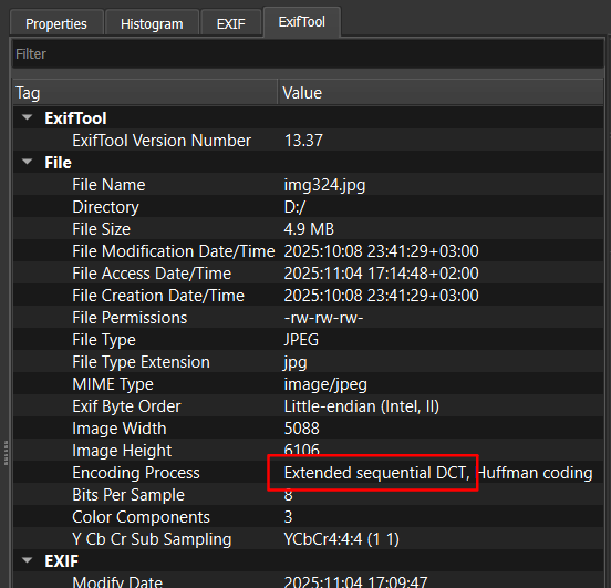

thank you for the answerxnview wrote: Tue Nov 04, 2025 1:53 pm i have no way to check that a jpeg file was compressed in JPEG-li
i've noticed that ExifTools shows a different value for JPEG-li files
or it is not a reliable marker?
