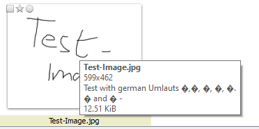

The Encoding of the Exif-Image-Description-Field ist always interpreted aus "UTF-8" in XnView MP
Using the old XNView 1.9.6, "ISO 8859-1" (or some similar Coding) was used to read the Exif Description field.
Unfortunately I have lots of images having Exif-Decriptions including german umlauts, which now cannot be displayed correctly.
e.g.: "Test with german Umlauts ä,ö, ü, Ä, Ö. Ü and ß"

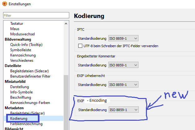

So it would be great to have an additional configuration-combobox, where you can define the encoding of the Exif-Field-String-Values.
Then I could view my old images including the image description without converting all exif data somehow to UTF-8.
As deluxe-solution, the exif image description could by tried do decode as "UTF-8". If there are byte-sequences, which cannot be correctly decoded as "UTF-8" and are then displayed as <?>, "ISO 8859-1" should be used to decode the field. So it would be more independent and robust when interpreting the image-description.
