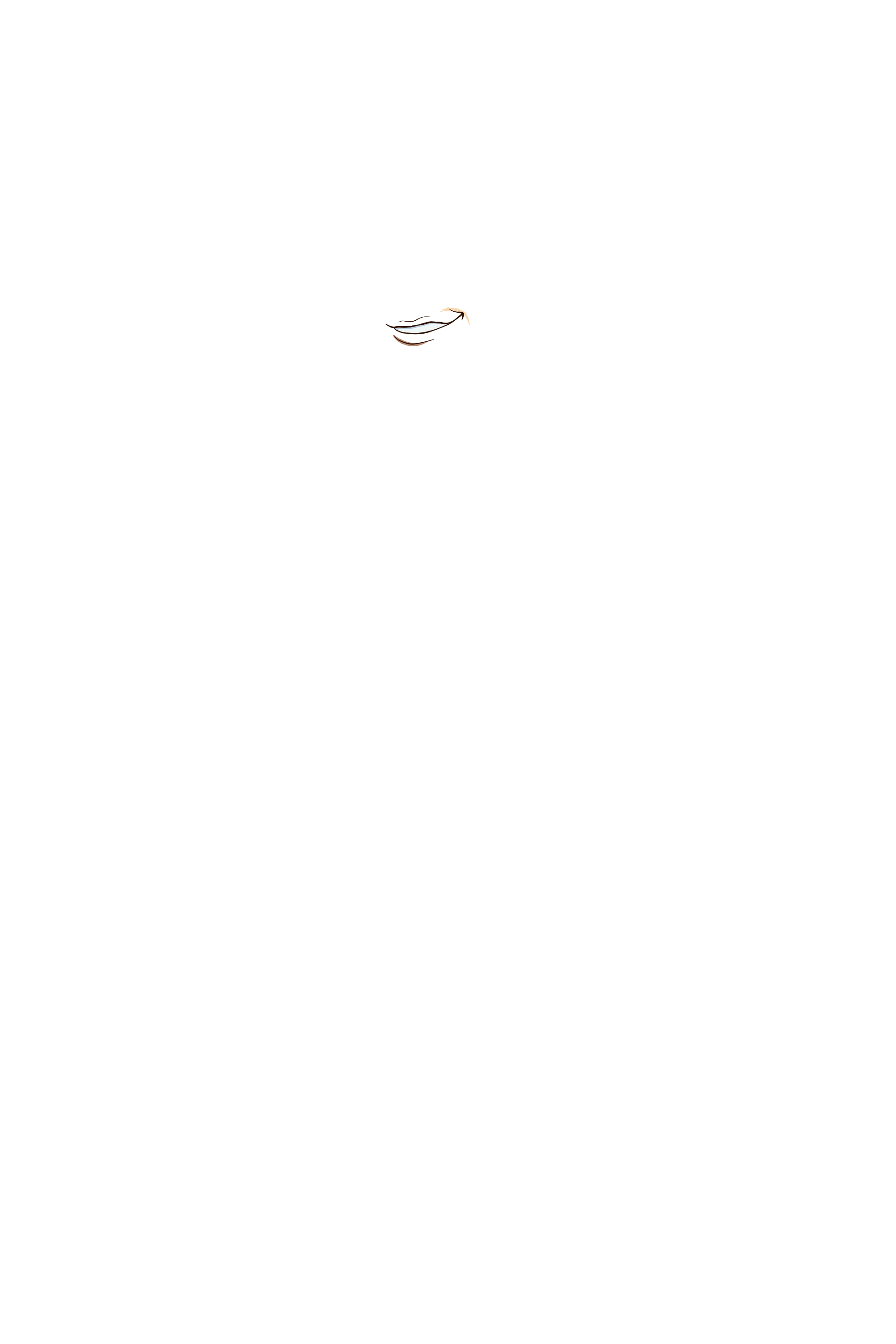

It's a bit hard to see, but these are a .png series of facial parts that will be layered over other images. (look towards the center of the .pngs)
I reduced mouth1.png to mouth 2.png using Lanczos (and all the others had a similar result...the gray stuff around the edge of the small peach area.)
Any advice appreciated, thank you again!

And yes, it was a reduction in size. It might seem like I enlarged the .png but I think the forum automatically blows up the .pngs to whatever size fits the post.

Missletoss wrote:And yes, it was a reduction in size.
Did you resize by pixels or percentage?
  • Input: mouth1.png (2000×3000 px)
  • Output: mouth2.png (526×790 px)
Missletoss wrote:I'm using SAI unfortunately.
Systemax PaintTool SAI?
png-halo-remove wrote:Command line tool / API to remove the "White Halo" Artifact on Transparent PNGs saved by programs such as Adobe Photoshop. (White are halos noticeable when an image is resized with linear filtering, this program will smear the border color out on fully transparent-pixels)
Currently only works on 32-bit (RGBA) PNG files
Sorry I couldn't be any more help :-|
We really need a solution. Even the official icon for XnView Classic has this effect:
  • Image
How about extracting the alpha channel and resizing it separately?
By pixels.
I'll try that, but not sure what I do with it after that to get it transparent again?

Can you confirm that the Keep ratio checkbox for the Resize action has no effect in v1.60 of XnConvert for Windows?
Missletoss wrote:
XnTriq wrote:How about extracting the alpha channel and resizing it separately?
XnConvert lets you extract the RGBA channels of 32-bit PNGs. As it turns out, only NConvert (the command-line version) can load/merge an alpha channel mask.
We'll have to wait & see what Pierre (the developer of everything Xn) says. In the meantime, I've done a few tests with the sample you've provided:
  • Image Adobe Photoshop v6.0.1 (Bicubic) + fnord SuperPNG v1.1
    Image Corel Photo-Paint v11.633 SP2
    Image Greenfish Icon Editor Pro v3.31
    Image Human Balance GraphicsGale v1.93
    Image Jasc Paint Shop Pro v9.01 (Smart)
    Image Macromedia Fireworks v4.0.2 (Bicubic)
    Image PhotoFiltre v7.1.2 (Lanczos)
    Image Sib Icon Editor v4.00 (Lanczos3)
    Image ThumbsPlus v7.0 SP2 build 2251
    Image XnView v2.13 (Lanczos)
test.zip
(26.21 KiB) Downloaded 383 times

The Keep Ratio button does work. When I click it, it the image will stretch or not accordingly. Is that what you mean?
Wow! The test results are really interesting. It seems like there is a very wide range in terms of what programs will do.
Posts: 6523
Re: Reducing Halo Effect in Rescaled/Resized Images
Missletoss wrote:The Keep Ratio button does work. When I click it, it the image will stretch or not accordingly. Is that what you mean?
Yes, that's what I'm talking about. Thanks for checking. When Keep ratio is activated and I change the value for Width, the Height stays the same.
Missletoss wrote:Wow! The test results are really interesting. It seems like there is a very wide range in terms of what programs will do.
Right, especially in those cases where the same algorithm is used :?

Top to bottom:
  1. Adobe Photoshop v6.0.1 (Bicubic) + fnord SuperPNG v1.1
  2. Corel Photo-Paint v11.633 SP2
  3. Greenfish Icon Editor Pro v3.31
  4. Human Balance GraphicsGale v1.93
  5. Jasc Paint Shop Pro v9.01 (Smart)
  6. Macromedia Fireworks v4.0.2 (Bicubic)
  7. PhotoFiltre v7.1.2 (Lanczos)
  8. Sib Icon Editor v4.00 (Lanczos3)
  9. ThumbsPlus v7.0 SP2 build 2251
  10. XnView v2.13 (Lanczos)
Left to right:
  1. View » Show Mask
  2. View » Use alpha channel on
  3. View » Use alpha channel off
