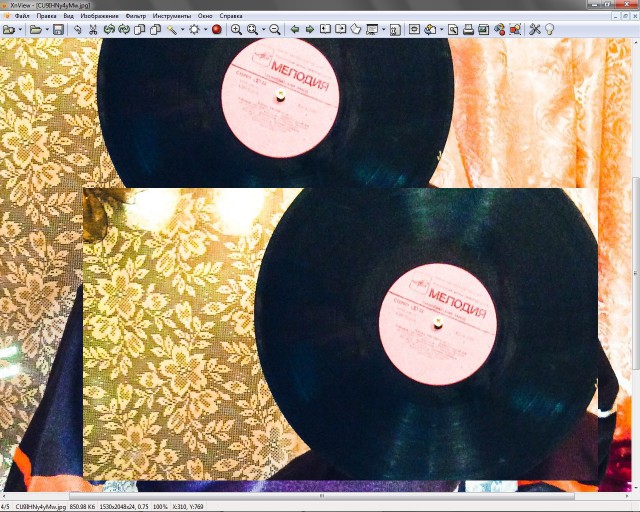

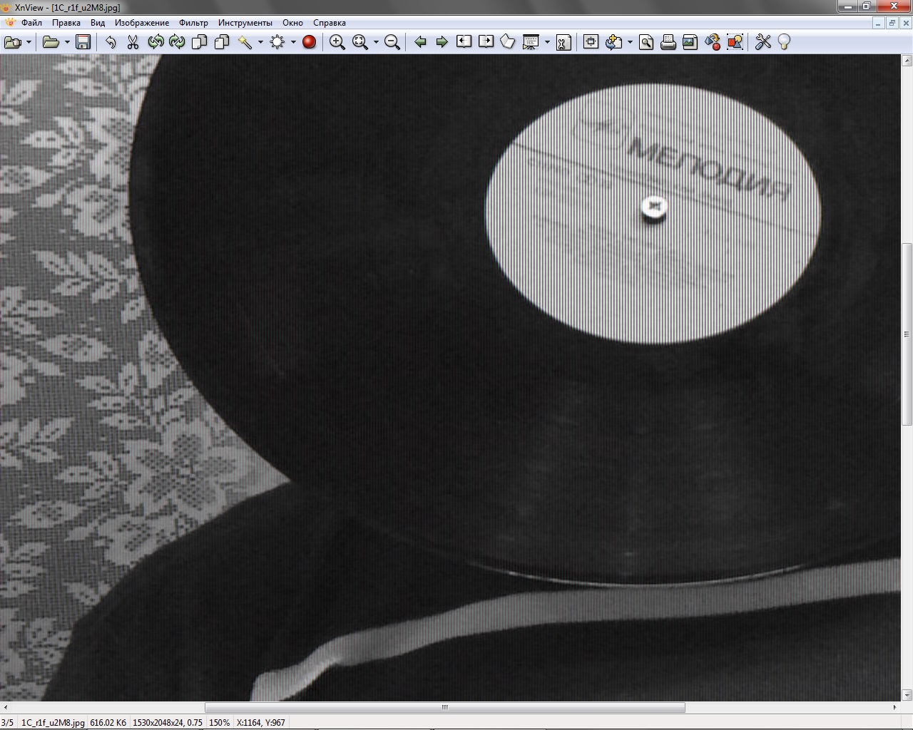

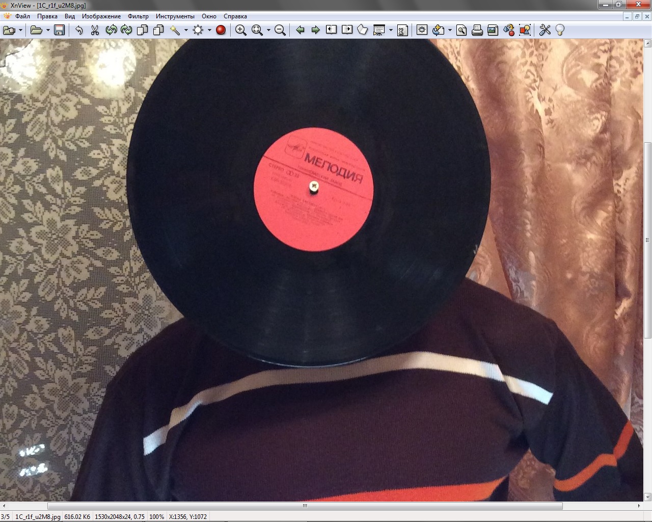

Hello! Firstly, thank you for a wonderful program!
For many years, regularly worked perfect. But with the upgrade to v2.30 happened, in my opinion, critical bug. The situation is similar with the topic-starter, but not when resizing, and by simply zooming in more than 100%.
Windows 7 x64.
P.S.
Also, sometimes after "overzooming" do not work mouse wheel or keyboard buttons for "next/previous file".
Windows 7 x64.
P.S.
- Posts: 47521
Justik
- Posts: 18
- Joined: Thu Feb 19, 2015 9:17 pm
Re: XnView does not resize image - version 2.25
Yes. Now turn off this option and everything seems fine. But I liked it...xnview wrote:do you use high zoom quality enlarge??

I have the same problem with v2.30. And I did not have it before that update. I turned off high zoom quality enlarge and it is ok, but it is much pixelized now... And the problem with this black and white picture zoom is only happening with .jpeg files.
