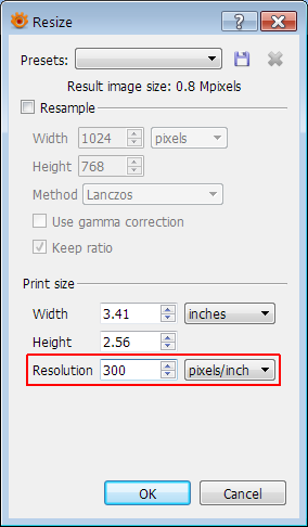

Update:
In XnViewMP it looks as if the DPI adjustment has been incorporated into Image > Resize...
I think the following setting should provide the DPI value you need without any resampling:
fairyhedgehog

Re: Unable to change DPI of JPG image
Post by fairyhedgehog »
Thank you.
I've tried that, and it works according to XnView. Unfortunately Windows is continuing to report the lower dpi.
Maybe I'd better just download classic XnView and take it from there!
