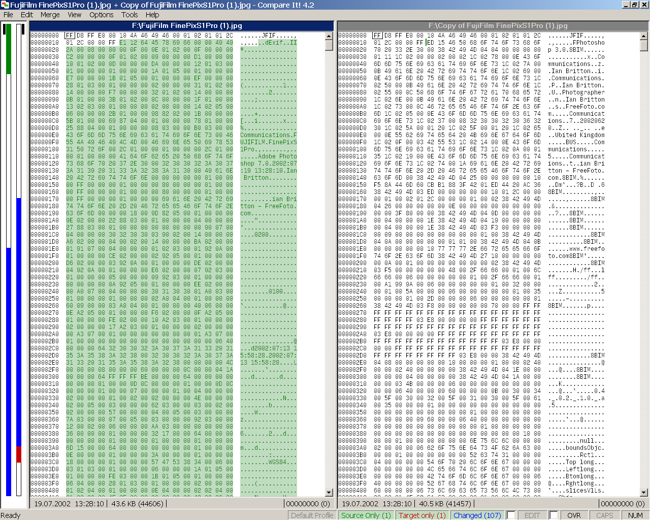

Bug confirmed :-|
I used FujiFilm FinePixS1Pro (1).jpg and CompareIt! (Find moved sections & Align mode activated) for my tests.

Yes, in the browser. (cmd_CleanMetadata isn't available in view mode, I believe.)
