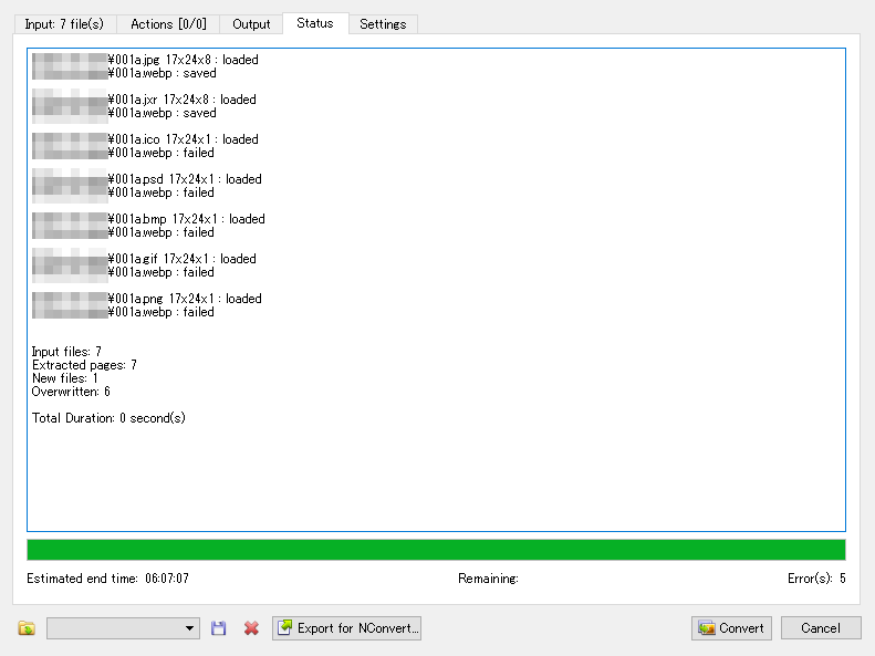

Experiment and result (picture referring)
1bit Binary image was changed to the various forms.
An error has occurred to a picture of 1bit.
Because jpg and jxr are a picture of 8bit.
A change succeeded as a result.
This is possible in nomal-xnview, so I wish to be improved.

Re: Using 1bit binary image, webp-Batch convert. failed.
you need to add a change color depth 24bits action
