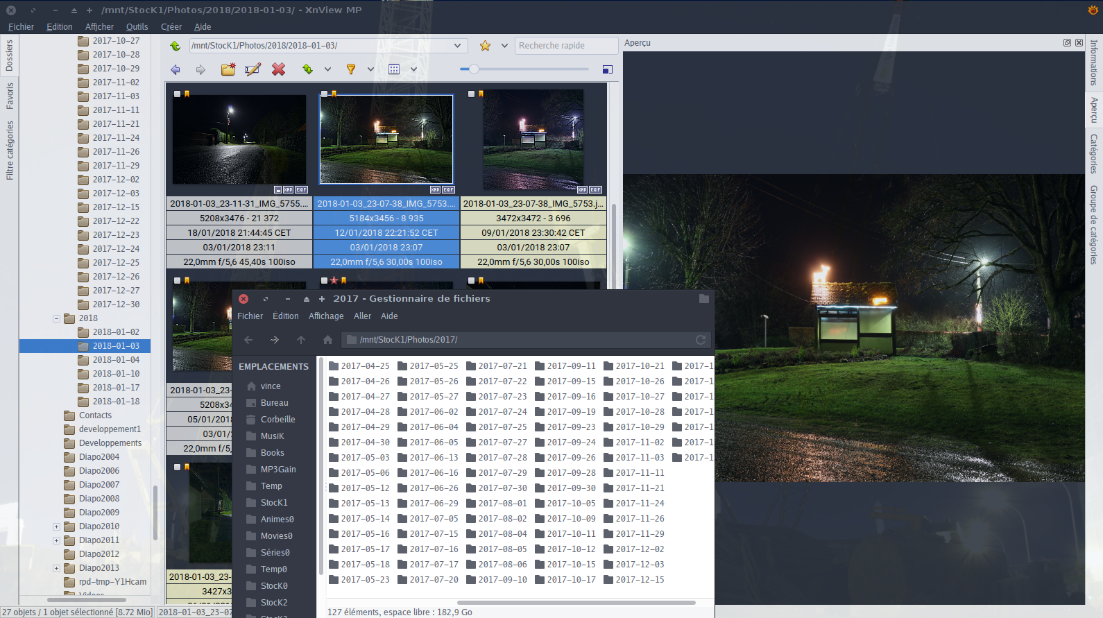

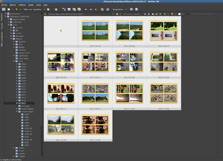

That's bad luck for you! On my Ubuntu boxes, these new libs fix the folder icons (see attached screenshot).sissou wrote:No change in icon theme with these new files !

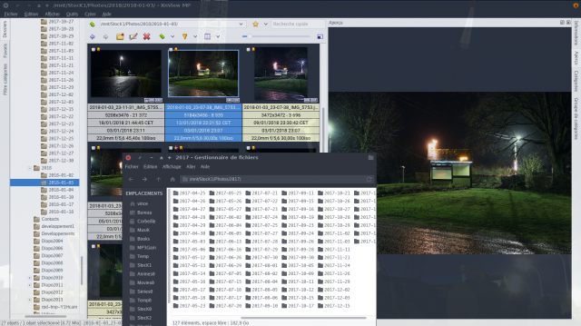

Here's how XNView interface does look on my session :
No luck indeed
Re: 0.88 Linux. system theme not adhered
It was working a few versions ago though...
So you are french toosissou wrote:It was working a few versions ago though...
