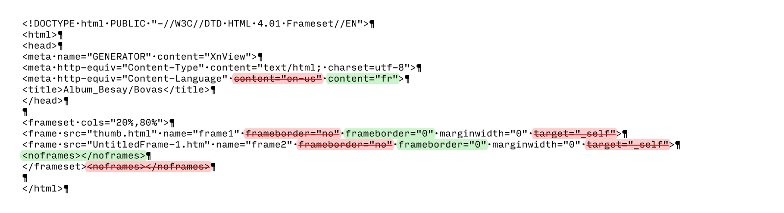

claude gobez wrote: Sat Aug 11, 2018 12:44 pmDonc, ma première demande reste inutile.
  • /Pages_galerie_photos/25_Pelleteuse_Bessay-Bovas/index.html
    <!DOCTYPE html PUBLIC "-//W3C//DTD HTML 4.01 Frameset//EN">
    <html>
    <head>
    <meta name="GENERATOR" content="XnView">
    <meta http-equiv="Content-Type" content="text/html; charset=utf-8">
    <meta http-equiv="Content-Language" content="fr">
    <title>Album_Besay/Bovas</title>
    </head>
    <frameset cols="20%,80%">
    <frame src="thumb.html" name="frame1" frameborder="0" marginwidth="0">
    <frame src="UntitledFrame-1.htm" name="frame2" frameborder="0" marginwidth="0">
    <noframes></noframes>
    </frameset>
    </html>

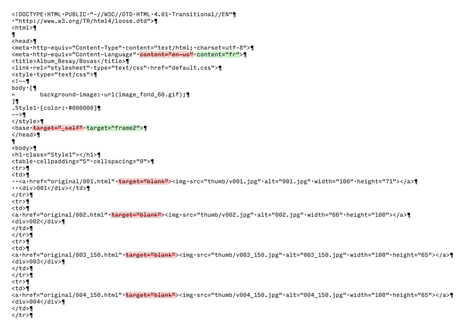

  • /Pages_galerie_photos/25_Pelleteuse_Bessay-Bovas/thumb.html
    <!DOCTYPE HTML PUBLIC "-//W3C//DTD HTML 4.01 Transitional//EN"
     "http://www.w3.org/TR/html4/loose.dtd">
    <html>
    <head>
    <link rel="stylesheet" type="text/css" href="default.css">
    <style type="text/css">
    body {
    	background-image: url(image_fond_60.gif);
    .Style1 {color: #000000}
    </style>
    <base target="frame2">
    </head>
    <body>
    <h1 class="Style1"></h1>
    <table cellpadding="5" cellspacing="0">
    <tr>
    <td>
      <a href="original/001.html"><img src="thumb/v001.jpg" alt="001.jpg" width="100" height="71"></a>
      <div>001</div></td>
    </tr>
    <tr>
    <td>
    <a href="original/002.html"><img src="thumb/v002.jpg" alt="002.jpg" width="66" height="100"></a>
    <div>002</div>
    </td>
    </tr>
    <tr>
    <td>
    <a href="original/003_150.html"><img src="thumb/v003_150.jpg" alt="003_150.jpg" width="100" height="65"></a>
    <div>003</div>
    </td>
    </tr>
    <tr>
    <td>
    <a href="original/004_150.html"><img src="thumb/v004_150.jpg" alt="004_150.jpg" width="100" height="65"></a>
    <div>004</div>
    </td>
    </tr>
    <tr>
    <td>
    <a href="original/005_150.html"><img src="thumb/v005_150.jpg" alt="005_150.jpg" width="100" height="65"></a>
    <div>005</div>
    </td>
    </tr>
    <tr>
    <td>
    <a href="original/006_150.html"><img src="thumb/v006_150.jpg" alt="006_150.jpg" width="100" height="65"></a>
    <div>006</div>
    </td>
    </tr>
    <tr>
    <td>
    <a href="original/007_150.html"><img src="thumb/v007_150.jpg" alt="007_150.jpg" width="100" height="71"></a>
    <div>007</div>
    </td>
    </tr>
    <tr>
    <td>
    <a href="original/008.html"><img src="thumb/v008.jpg" alt="008.jpg" width="69" height="100"></a>
    <div>008</div>
    </td>
    </tr>
    <tr>
    <td>
    <a href="original/009.html"><img src="thumb/v009.jpg" alt="009.jpg" width="100" height="69"></a>
    <div>009</div>
    </td>
    </tr>
    <tr>
    <td>
    <a href="original/010_150.html"><img src="thumb/v010_150.jpg" alt="010_150.jpg" width="100" height="79"></a>
    <div>010</div>
    </td>
    </tr>
    <tr>
    <td>
    <a href="original/011_150.html"><img src="thumb/v011_150.jpg" alt="011_150.jpg" width="100" height="68"></a>
    <div>011</div>
    </td>
    </tr>
    <tr>
    <td>
    <a href="original/012.html"><img src="thumb/v012.jpg" alt="012.jpg" width="100" height="68"></a>
    <div>012</div>
    </td>
    </tr>
    <tr>
    <td>
    <a href="original/013_96.html"><img src="thumb/v013_96.jpg" alt="013_96.jpg" width="65" height="100"></a>
    <div>013</div>
    </td>
    </tr>
    <tr>
    <td>
    <a href="original/014_150.html"><img src="thumb/v014_150.jpg" alt="014_150.jpg" width="70" height="100"></a>
    <div>014</div>
    </td>
    </tr>
    <tr>
    <td>
    <a href="original/015_150.html"><img src="thumb/v015_150.jpg" alt="015_150.jpg" width="70" height="100"></a>
    <div>015</div>
    </td>
    </tr>
    <tr>
    <td>
    <a href="original/016_150.html"><img src="thumb/v016_150.jpg" alt="016_150.jpg" width="75" height="100"></a>
    <div>016</div>
    </td>
    </tr>
    <tr>
    <td>
    <a href="original/017_150.html"><img src="thumb/v017_150.jpg" alt="017_150.jpg" width="73" height="100"></a>
    <div>017</div>
    </td>
    </tr>
    <tr>
    <td>
    <a href="original/018.html"><img src="thumb/v018.jpg" alt="018.jpg" width="70" height="100"></a>
    <div>018</div>
    </td>
    </tr>
    <tr>
    <td>
    <a href="original/019_150.html"><img src="thumb/v019_150.jpg" alt="019_150.jpg" width="71" height="100"></a>
    <div>019</div>
    </td>
    </tr>
    <tr>
    <td>
    <a href="original/020_150.html"><img src="thumb/v020_150.jpg" alt="020_150.jpg" width="71" height="100"></a>
    <div>020</div>
    </td>
    </tr>
    <tr>
    <td>
    <a href="original/021_150.html"><img src="thumb/v021_150.jpg" alt="021_150.jpg" width="71" height="100"></a>
    <div>021</div>
    </td>
    </tr>
    <tr>
    <td>
    <a href="original/022.html"><img src="thumb/v022.jpg" alt="022.jpg" width="70" height="100"></a>
    <div>022</div>
    </td>
    </tr>
    <tr>
    <td>
    <a href="original/023_150.html"><img src="thumb/v023_150.jpg" alt="023_150.jpg" width="71" height="100"></a>
    <div>023</div>
    </td>
    </tr>
    <tr>
    <td>
    <a href="original/024_150.html"><img src="thumb/v024_150.jpg" alt="024_150.jpg" width="71" height="100"></a>
    <div>024</div>
    </td>
    </tr>
    <tr>
    <td>
    <a href="original/025z_150.html"><img src="thumb/v025z_150.jpg" alt="025z_150.jpg" width="71" height="100"></a>
    <div>025</div>
    </td>
    </tr>
    <tr>
    <td>
    <a href="original/026.html"><img src="thumb/v026.jpg" alt="026.jpg" width="72" height="100"></a>
    <div>026</div>
    </td>
    </tr>
    <tr>
    <td>
    <a href="original/027.html"><img src="thumb/v027.jpg" alt="027.jpg" width="72" height="100"></a>
    <div>027</div>
    </td>
    </tr>
    <tr>
    <td>
    <a href="original/028_150.html"><img src="thumb/v028_150.jpg" alt="028_150.jpg" width="71" height="100"></a>
    <div>028</div>
    </td>
    </tr>
    <tr>
    <td>
    <a href="original/029_150.html"><img src="thumb/v029_150.jpg" alt="029_150.jpg" width="100" height="71"></a>
    <div>029</div>
    </td>
    </tr>
    <tr>
    <td>
    <a href="original/030_150.html"><img src="thumb/v030_150.jpg" alt="030_150.jpg" width="100" height="72"></a>
    <div>030</div>
    </td>
    </tr>
    <tr>
    <td>
    <a href="original/031_150.html"><img src="thumb/v031_150.jpg" alt="031_150.jpg" width="98" height="100"></a>
    <div>031</div>
    </td>
    </tr>
    <tr>
    <td>
    <a href="original/032.html"><img src="thumb/v032.jpg" alt="032.jpg" width="100" height="73"></a>
    <div>032</div>
    </td>
    </tr>
    <tr>
    <td>
    <a href="original/033_300.html"><img src="thumb/v033_300.jpg" alt="033_300.jpg" width="100" height="67"></a>
    <div>033</div>
    </td>
    </tr>
    <tr>
    <td>
    <a href="original/034.html"><img src="thumb/v034.jpg" alt="034.jpg" width="100" height="75"></a>
    <div>034</div>
    </td>
    </tr>
    <tr>
    <td>
    <a href="original/035_150.html"><img src="thumb/v035_150.jpg" alt="035_150.jpg" width="100" height="65"></a>
    <div>035</div>
    </td>
    </tr>
    <tr>
    <td>
    <a href="original/036.html"><img src="thumb/v036.jpg" alt="036.jpg" width="100" height="66"></a>
    <div>036</div>
    </td>
    </tr>
    <tr>
    <td>
    <a href="original/037_150.html"><img src="thumb/v037_150.jpg" alt="037_150.jpg" width="100" height="67"></a>
    <div>037</div>
    </td>
    </tr>
    <tr>
    <td>
    <a href="original/038.html"><img src="thumb/v038.jpg" alt="038.jpg" width="100" height="74"></a>

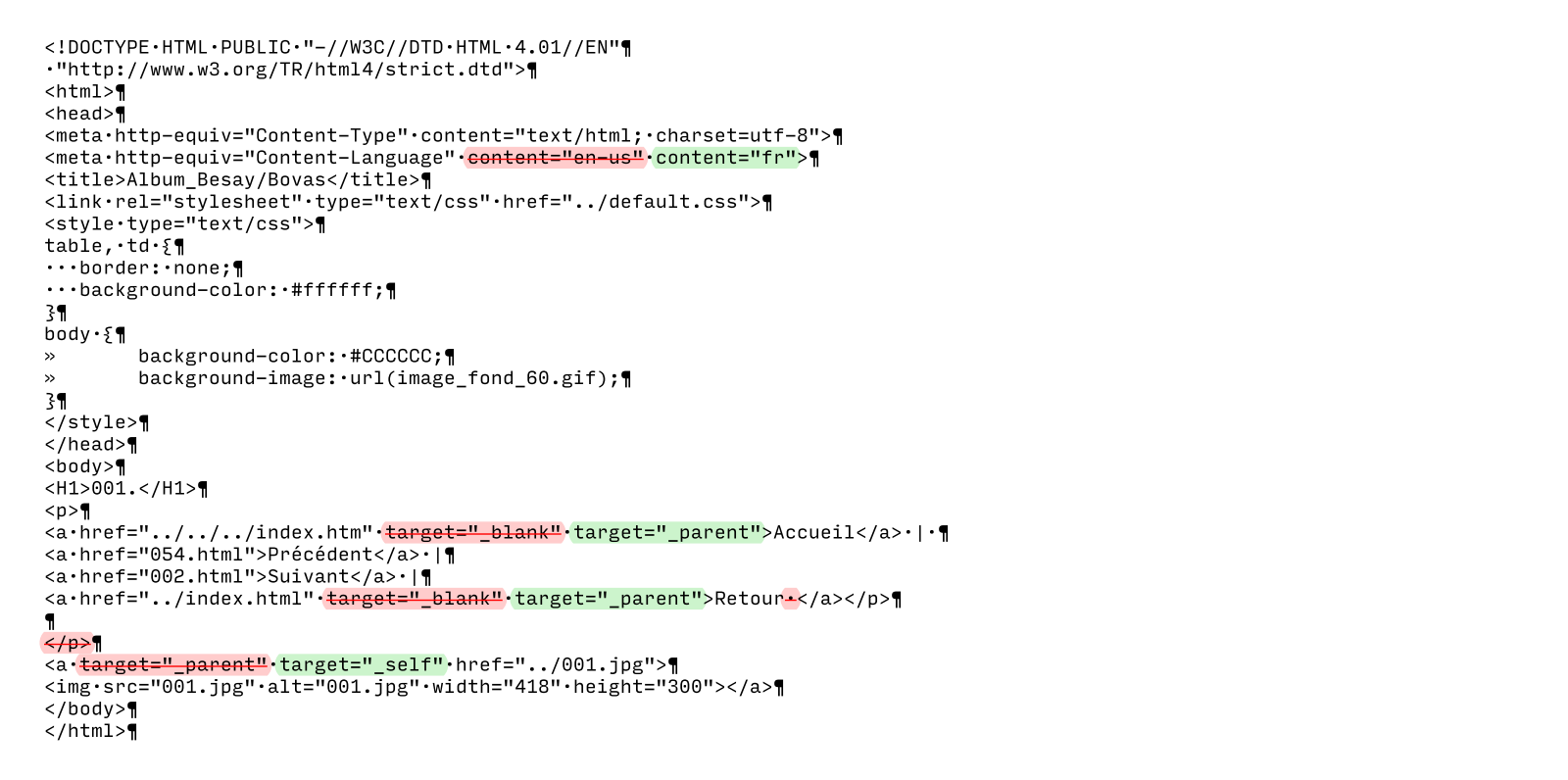

Bonjour XnTriq
Si je vous ai bien compris et malgrès mon message " .....ma première demande reste inutile..."
j'ai fais les modifications de la page "page.html" supprimer le code en rouge remplacer par le code en vert.
j'ai fais également les même modifications de la page "Index.html.
Après vérification sur Google Chrome et 5 onglets en même temps le problème n'est plus.
merci à vous et à Pierre.
je m'absente pour une douzaine de jours.
Cordialement
Claude
