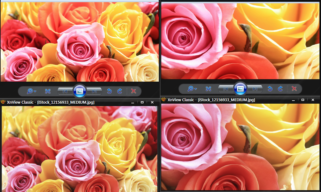

XnView seems to be the only program that displays the picture of roses found on this page with a dull or dead coloring, instead of the bright coloring that the picture has. Can we look into this? Hopefully you see this issue on your end just as I see it here. Thank you.

please post a screenshot?

Post by Phenomenon »
Here it is:
Posts: 46974
Re: Apparently wrong coloration for this one picture
do you have checked options>General>ICC?
Thanks. It was not checked, which is how it comes by default. Checking it fixes the coloring. To know more about the option, I went to read this topic. This many years later, does keeping it checked still make images load slower? I don't notice much difference in loading speeds.
