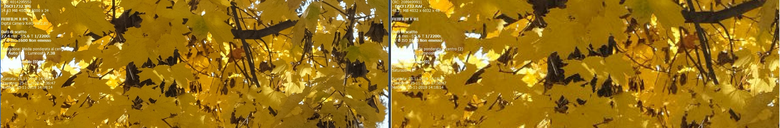

Good evening, I write to get information about the .RAF files of my Fujifilm H1.
When I open the .raf file, the display is very "poor" even when compared with the corresponding .jpeg
I send a comparison to explain myself.
I stress that with .RAF files of other Fujifilm cameras, the phenomenon does not occur.
How is it possible?
Thanks
Lorenzo
