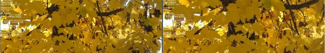

Good evening, I write to get information about the .RAF files of my Fujifilm H1.
When I open the .raf file, the display is very "poor" even when compared with the corresponding .jpeg
I send a comparison to explain myself.
I stress that with .RAF files of other Fujifilm cameras, the phenomenon does not occur.
How is it possible?
Thanks
Lorenzo
How is it possible?
Thanks
Lorenzo
phototweak
- Posts: 22
- Joined: Fri Aug 13, 2010 11:56 am
Re: Unsupported *.raf images
This is also a problem for me in XNView Classic 2.50. Fujifilm compressed RAF files from an X-H1 display as black, unless I use only Embedded Thumbnail. Uncompressed Bayer RAF files display fully.
