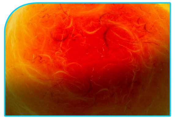

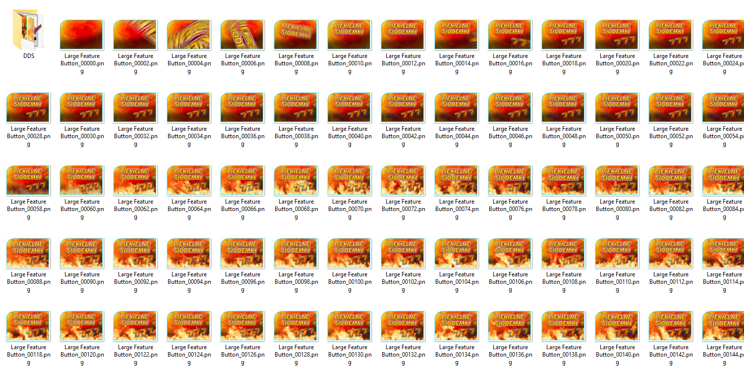

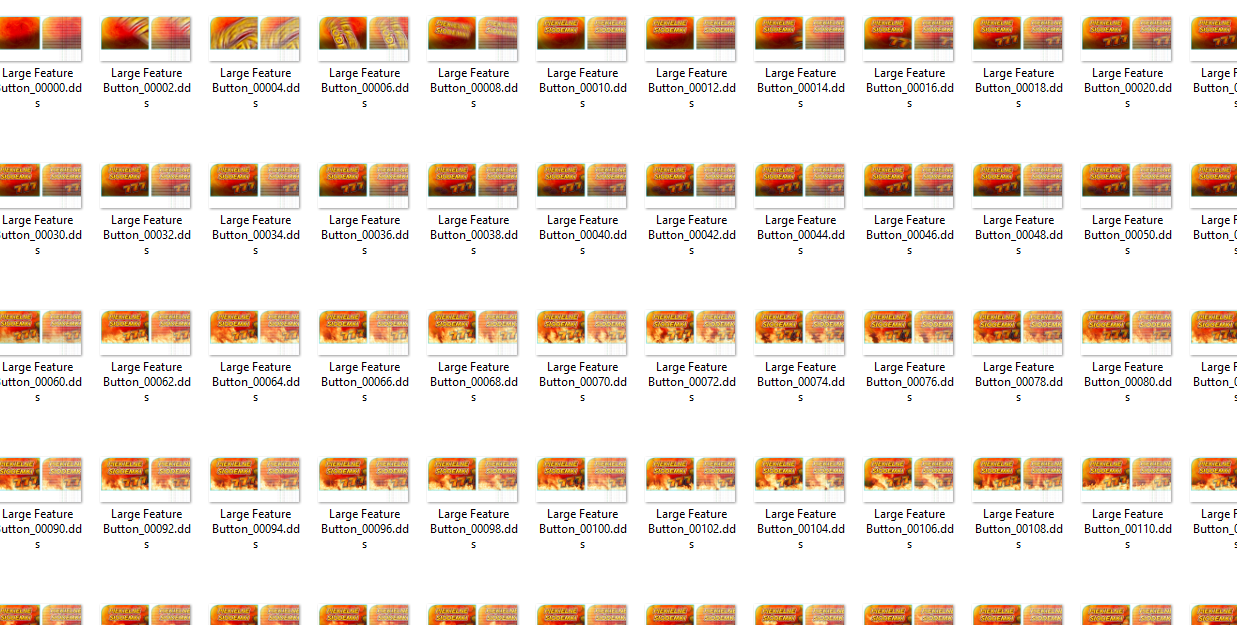

Hi all, simply trying to convert (literally what this program is supposedly made for) some PNG's to DDS' and maintain the original size. Instead I get the result with this weird duplication thing going on.
I've even retried it adding an action to resize the canvas to the original aspect size and it still changes the size of my image and adds the weird duplicate on the right.
Any help would be appreciated as I've had to create an account just to post this...

Attached is 1 of the pngs and the corresponding DDS.
The "Before" and "After" tabs seem to show the correct images but when it's time to actually go it saves as something totally different.

I've just done a quick test converting a JPEG into a DDS with no actions selected, and the resulting image had a black band at the bottom, so looks like an XnConvert DDS error.
Maybe Pierre can take a look using your file above when he has time...
