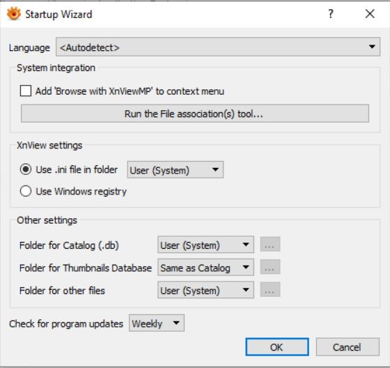

When I installed the application, I installed it for everyone. When different people log onto the computer and they open the application or click on an associated image for the first time, they are presented with
Startup Wizard.JPG (43.7 KiB) Viewed 1783 times
It is a one time thing, but they are presented with the option of Check for programs weekly. It can be changed to monthly as well as Never. The people do not have admin rights. If they are constantly being told about an update, it could be annoying to them. I would prefer to set this to Never as the default, versus having to ask them to change it themselves.
