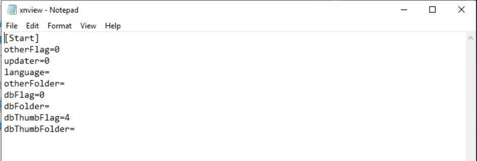

On Friday, with a test account, I opened the application for the first time and selected Never for the updater at the Startup Wizard. After doing so, the application opened. While opened I copied the XnViewMP folder, located in the Appdata-Roaming folder. This is what the ini file looked like:
I copied the XnViewMP folder(including the xnview ini, xnviewmp database, thumbnail database) to the Appdata-Roaming folder of the Default user. The idea is for people accessing the computer for the first time, to get that folder copied to their individual roaming folder, eliminating the prompting of the Startup Wizard.
I tested it with new test accounts to see what would happen. And it seems to open fine with the correct settings. Does that work as well or are there any known issues with doing that?

cday wrote: Mon Nov 04, 2019 12:59 pm So now when a new user opens 'MP for the first time, the startup wizard is displayed with check for updates set to 'never', what you wanted? :D .
Doing this actually bypasses the startup wizard entirely as the ini file is already in their Appdata-Roaming folder(copied from Default User).
