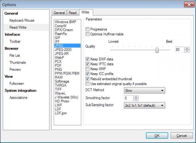

I have now tested using XnView 2.49.2 for Q91 and Q61 with the settings below, and the resulting file sizes vary as expected.
I'm afraid currently I can't suggest any explanation for the behavior you obtained, but possibly if you examine the detailed properties of the attached output files you identify an explanation.
