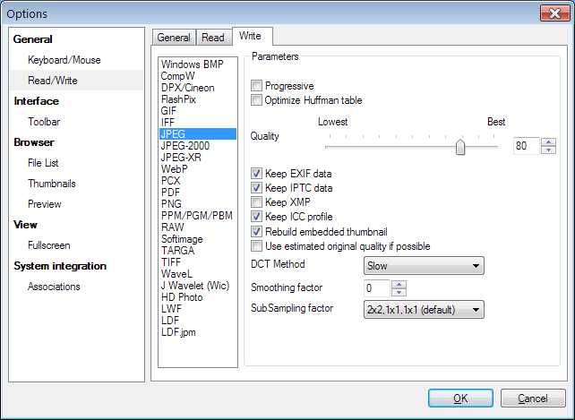

Posts: 4622
Re: JPG compression does not work
I have now tested using XnView 2.49.2 for Q91 and Q61 with the settings below, and the resulting file sizes vary as expected.
I'm afraid currently I can't suggest any explanation for the behavior you obtained, but possibly if you examine the detailed properties of the attached output files you identify an explanation.
If you are unable to resolve the issue you could test again using XnView MP, which in any case can be regarded as the future of XnView, or the stand-alone batch conversion software XnConvert...
