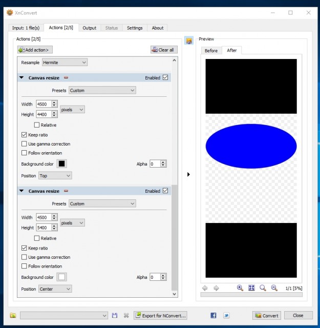

Thank you for your last inspiration. Yes it works if I change it a little bit.
I do two canvas resizes:
At the first Canvas resize I do the height smaller then I really want (4400)
as output and set the position to top.
Then I do a second resize and set the height to the height I really want (5400)
and set the position to center. And I set the Alpha to 0.
Now I have the margin to the top that I want:
Thank you for all your tipps!
But I have a last question: Is a color with Alpha=0 the same as a transparent area?
Because it's not possible to set a Background color to "transparent".
In the preview it seems to be so.
If not, I don't know if I would get problems with this solution.

H5T7P4 wrote: Thu Apr 09, 2020 3:18 pm But I have a last question: Is a color with Alpha=0 the same as a transparent area?
I'm afraid I don't know, my knowledge of transparency is still quite limited, you could find out more about transparency online, but there are two types to complicate matters
Because it's not possible to set a background color "transparent".
If you are now able to process one image successfully I would think, and hope, that there shouldn't be a problem.

For test I placed the XnConvert png output image in Illustrator top to a colored rectangle.
And the rectangle is shining through where is no ellipse area in the png.
So I think it's really transparent. Thanks again for your help.
