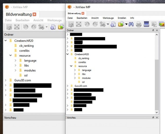

I am runnig a 4K Display and two 1920x1200 Displays with W10.
After scaling the 4K to 150% XnViewMP 0.96.5 font is smaller than normal on the 1920x1200 displays.
If I scale the 4K back to 100% the problem does not appear.
Any ideas how to fix this?

If I start XnView on the 4K 150% monitor scaling is fine on that display. If I then move XnView to the other display (1920x1200 100%) scaling is getting much smaller than it should.
Scaling the 4K to 100% and start XnView then everything on the 1920x1200 is in normal size. But of course, that is no solution for the 4K display.

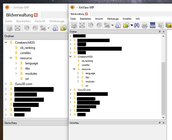

If I then go back to 4K 150% and start a 2nd XnView I have two XnView instances side by side on the 1920x1200. The first one with the normal scaling (before changing the 4K to 150%) and the one with the too small scaling. On the picture you can the difference.
