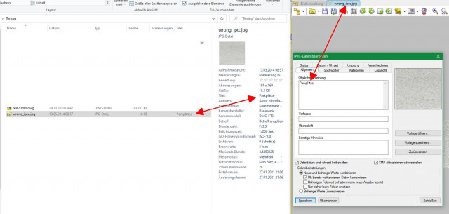

IPTC and German Umlaute
Post by Peter2 »
Seem to similar to the psoting from XnViewMP from 2013:
viewtopic.php?f=62&t=28057&p=111331&hil ... ut#p111331
When I add a IPTC value (e.g. string "Parkplätze") to key 120 (Description) with nconvert.exe, then the "umlaut" is displayed as "?". MS Explorer shows it correct.
When I enter the value with the dialogue in XnView, then it is displayed correctly also in XnView.
See image and example attached.

Re: IPTC and German Umlaute
it's strange, IPTC is marked as utf8 but string is locale encoded
I used Stuffware Photo Studio to extract the APP13 markers of wrong_iptc.jpg and a fixed version. Maybe this will help Pierre to identify the problem.
p167687_v2.zip
(43.08 KiB) Downloaded 224 times

IPTC:
  Date Created         (0x37): 20140513
  Time Created         (0x3c): 085758+0000
  Caption              (0x78): Parkpldtze
My Windows console is using code page 437:
cmd.exe wrote:
mode con cp
Status for device CON:
    Code page:      437
Results from Brandfolder's Extract Image Metadata Tool (including CurrentIPTCDigest + CodedCharacterSet + ApplicationRecordVersion):
wrong.jpg wrote:

CurrentIPTCDigest: e7d320ef1b4080c2af4c3d2fd7c441be
CodedCharacterSet: UTF8
ApplicationRecordVersion: 0
DateCreated: 2014:05:13
TimeCreated: 08:57:58+00:00
Caption-Abstract: Parkpl?tze

CurrentIPTCDigest: 7ce129a4d2b5fedb27f963553d6d8672
Caption-Abstract: Parkplätze
