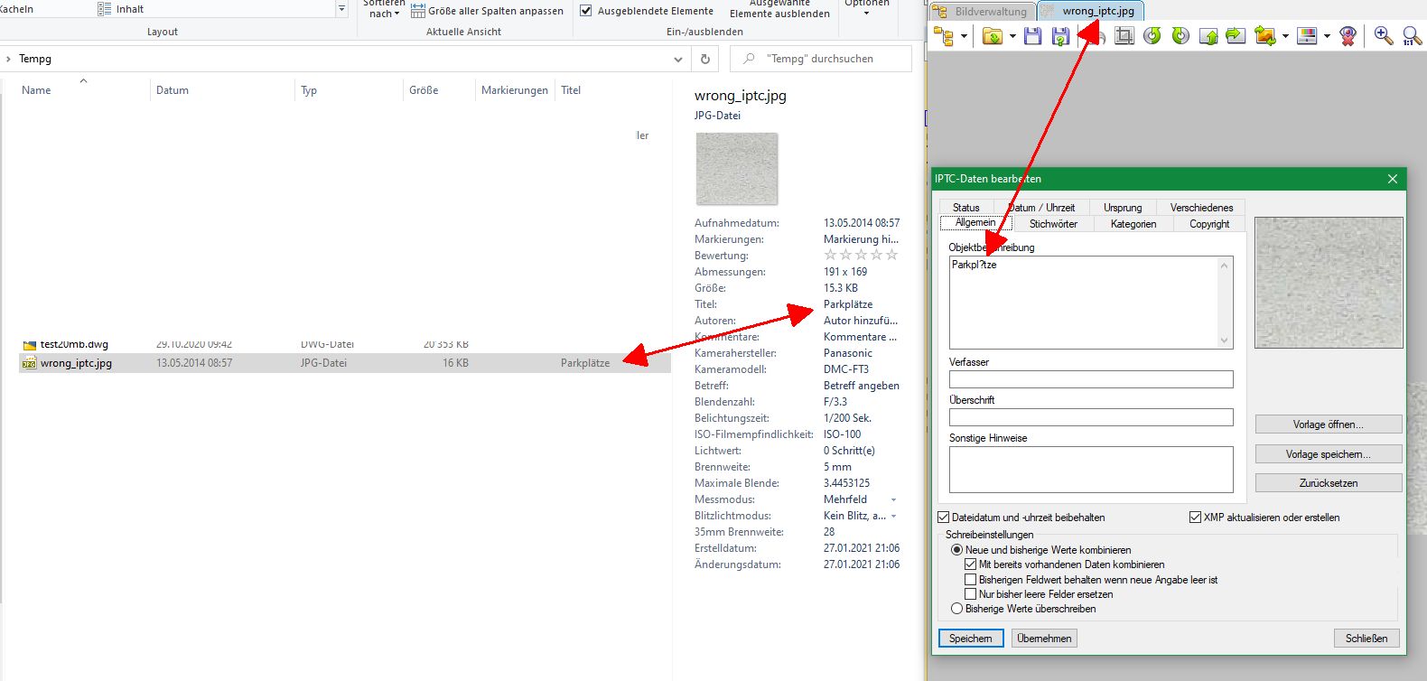

IPTC and German Umlaute
Post by Peter2 »
Seem to similar to the psoting from XnViewMP from 2013:
viewtopic.php?f=62&t=28057&p=111331&hil ... ut#p111331
When I add a IPTC value (e.g. string "Parkplätze") to key 120 (Description) with nconvert.exe, then the "umlaut" is displayed as "?". MS Explorer shows it correct.
When I enter the value with the dialogue in XnView, then it is displayed correctly also in XnView.
See image and example attached.

it's strange, IPTC is marked as utf8 but string is locale encoded

I used Stuffware Photo Studio to extract the APP13 markers of wrong_iptc.jpg and a fixed version. Maybe this will help Pierre to identify the problem.
Posts: 6572
Re: IPTC and German Umlaute
mahikeulbody (0.51: Display of UTF8 IPTC fields) wrote: Sun Aug 12, 2012 8:58 pm Exiftool doc : The Exiftool default when IPTC:CodedCharacterSet is not defined is Latin.
Exiftool FAQ : Note that unless CodedCharacterSet indicates UTF‑8, applications have no reliable way to determine the IPTC character encoding. For this reason, it is recommended that CodedCharacterSet be set to "UTF8" when creating new IPTC.
So, if I want IPTC tag encoded in UTF8 I have to do : exiftool -charset iptc=UTF8 -IPTC:City="Athènes" img.jpg -CodedCharacterSet=UTF8
I suppose that XnViewMP do it also.
So my problem is solved but that doesn't explain why XnViewMP displays "Athènes" in the Exiftool panel and "Athnes" in the IPTC panel when both CodedCharacterSet doesn't exist into the file and IPTC tag is Latin encoded. May be you don't use the same Exiftool command for each panel.
herb (UTF-8 missing in IPTC Encoding) wrote: Sat Jul 06, 2013 1:42 pmthanks for the new version 0.60 of XnViewMP and thanks for adding UTF8 to the list of possible IPTC encodings.
And sorry, but for me the problem is not fully corrected.
Yes, XnViewMP itself now uses the correct encoding to read IPTC data, but Exiftool does not.
For images - with IPTC metadata and without the tag CodedCharacterSet - Exiftool must be started with following option:
exiftool. exe -charset iptc=utf8 <imagefile>.
Please add this option when eExiftool is started.
https://www.exiftool.org/TagNames/IPTC.html#EnvelopeRecord wrote:(values are entered in the form “ESC X Y[, ...]”. The escape sequence for UTF-8 character coding is “ESC % G”, but this is displayed as “UTF8” for convenience. Either string may be used when writing. The value of this tag affects the decoding of string values in the Application and NewsPhoto records. This tag is marked as “unsafe” to prevent it from being copied by default in a group operation because existing tags in the destination image may use a different encoding. When creating a new IPTC record from scratch, it is suggested that this be set to “UTF8” if special characters are a possibility)
JPEGsnoop (wrong_iptc.jpg) wrote:
IPTC [001:090] Coded Character Set = " %G"
Exiv2: Iptc.Envelope.CharacterSet not reported correctly

IPTC:
  Date Created         (0x37): 20140513
  Time Created         (0x3c): 085758+0000
  Caption              (0x78): Parkpldtze
My Windows console is using code page 437:
cmd.exe wrote:
mode con cp
Status for device CON:
    Code page:      437
Results from Brandfolder's Extract Image Metadata Tool (including CurrentIPTCDigest + CodedCharacterSet + ApplicationRecordVersion):

CurrentIPTCDigest: e7d320ef1b4080c2af4c3d2fd7c441be
CodedCharacterSet: UTF8
ApplicationRecordVersion: 0
DateCreated: 2014:05:13
TimeCreated: 08:57:58+00:00
Caption-Abstract: Parkpl?tze

CurrentIPTCDigest: 7ce129a4d2b5fedb27f963553d6d8672
Caption-Abstract: Parkplätze
