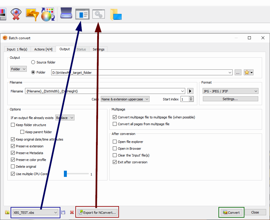

The Batch Conversion in XnViewMP has lots of good function. It would be lovely/perfect to combine afew standard fuction under "one button macro-action" - instead of marking images and starting batch converter and running thru single options again...

If I understood your request, it's automating the batch conversion, I talked about it here.
You can create a button associated with the script.

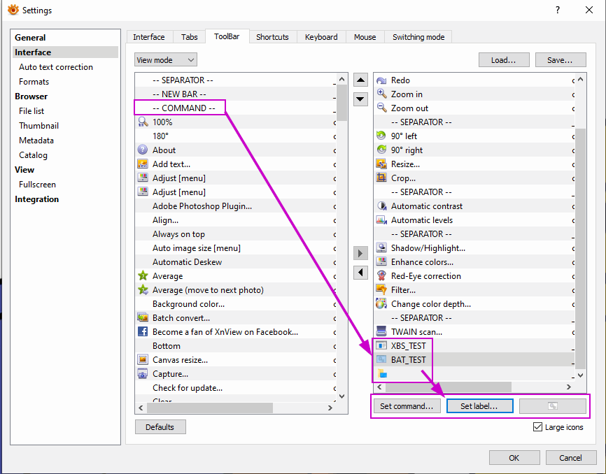

Hi
In the Settings/Interface/Toolbar, add --COMMAND-- and assign it an XBS file that you have created in Batch Convert.

Hi Franky,
did a setup but it doesn't work
What I've done so far and I add some screenshots - for everyone who follows this idea:
I can add in Settings/Interface/ToolBar/... more than one "--COMMAND--" into (both) ToolBar. In this case it is the ViewMode. Found as well in this window on the lower right "Set comman..." and "Set label.." option.
With "Set command..." I add *.xbs and *.bat saved files out of the "Batch Convert". This is how it looks like in my "foo.bar" (my own ToolBar file):
The "Convert"-button in the "Batch Convert"-GUI does the whole job, but the two buttons in the "ToolBar" don't...

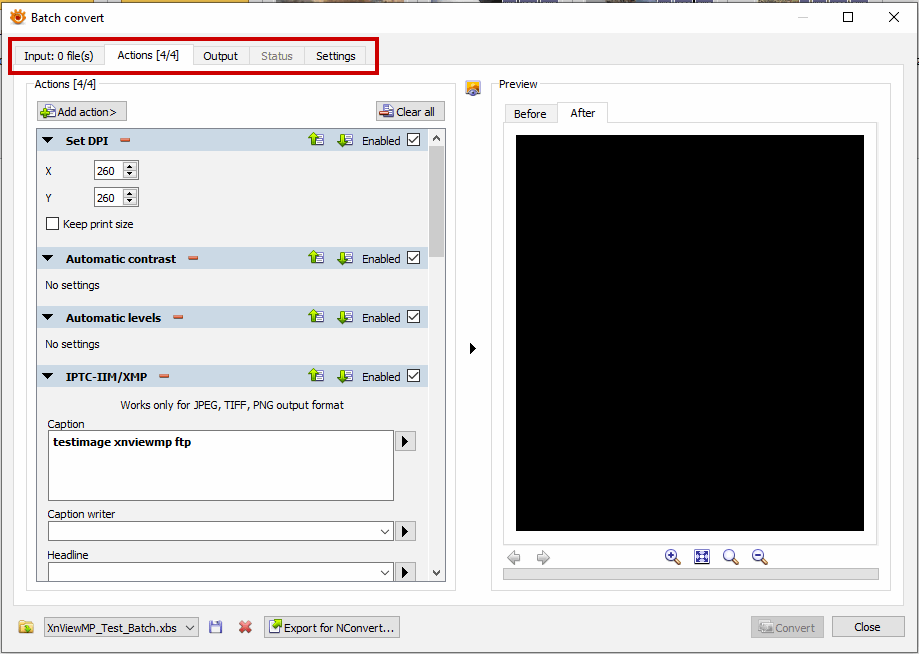

Button XBS_TEST.xbs (the xbs-file keeps all the options)
...could work as intent but I cat run it...
Where I am wrong with _cmd_=XBS_TEST;D:/XBS_TEST.xbs;D:/XBS_TEST.xbs
<!...the important lines ... >
_cmd_=BAT_TEST;D:/XN_BAT.bat;D:/XN_BAT.bat
_cmd_=;; <!... this is not assigned to commands ... >
<?xml version="1.0" encoding="UTF-8"?><XnView_script version="1.0" name="XBS_TEST">
<Set_DPI x="260" y="260" keep="false"/>
<Automatic_contrast/>
<Automatic_levels/>
<IPTC-IIM_XMP id_40="Test" id_105="XnViewMP FTP" id_120="test image xnviewmp ftp" id_122="Test" keepKeywords="true" replace="false" mode="1"/>
<Output folder="D:/XnViewMP_target_folder" filename="{Filename}_{DstWidth}_{DstHeight}" case="2" startIndex="1" format="JPEG">
<Options overwrite="0" orgDate="true" keepMeta="true" keepICC="true" keepFolder="false" keepParentFolder="false" keepExtension="true" delOrg="false" multipage="true" allPages="false" openExplorer="false" openBrowser="false" clearItems="false"/>
<JPEG quality="90" progressive="false" optimizeHuffman="false" rebuildThumb="true" orgQuality="true" DCTMethod="2" subSampling="0" smoothFactor="0"/>
</Output>
</XnView_script>
Gerald says thx to all!

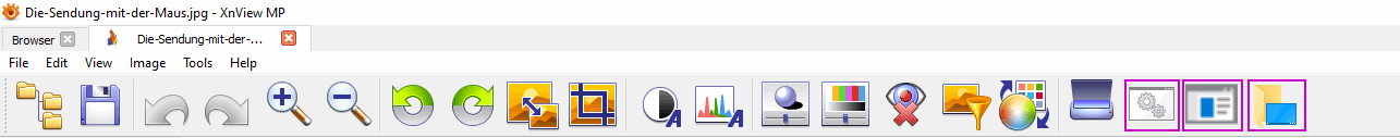

Re: Batch Convertion-Set in a "one-button-macro-action"
The button opens the batch convert with the defined options but you have to start the conversion manually.

Hi Franky, aaaah, ok...
Yes, if I add the --COMMAND-- in the ToolBar/Browser Mode... it actully opens the "Batch Convert" menu ... and yes, then I can press the "Batch Convert" button to run the script / convertion...
Thx for that and sorry for my missunderstandings...
My idea was to add "--COMMAND--" in the "ToolBar/View Mode:
click on image (images) and using the simplest function (dpi, auto color, auto contrast, standard iptc, send by ftp ... ) in a *.xbs
... and this I cant get it run...
Q.: Could it work? Any hint?

I just put the same button on the View mode and it does not work, nothing happens.
On the other hand we can open the batch convert with Ctrl + U but without the defined parameters
