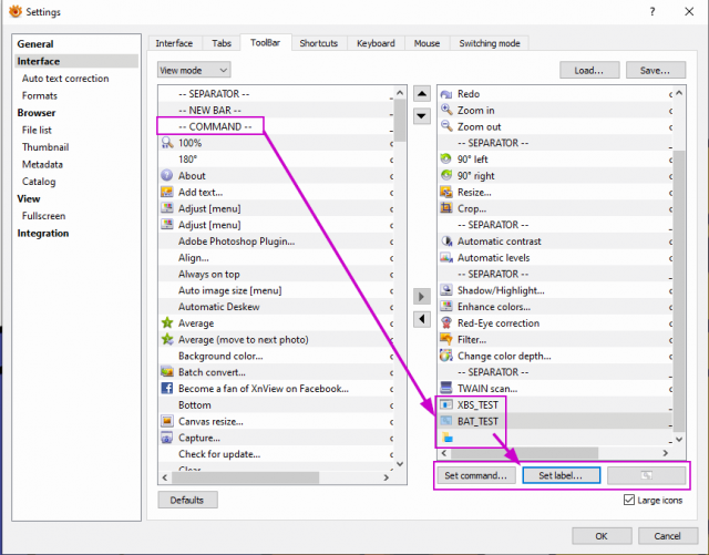

Hi
In the Settings/Interface/Toolbar, add --COMMAND-- and assign it an XBS file that you have created in Batch Convert.

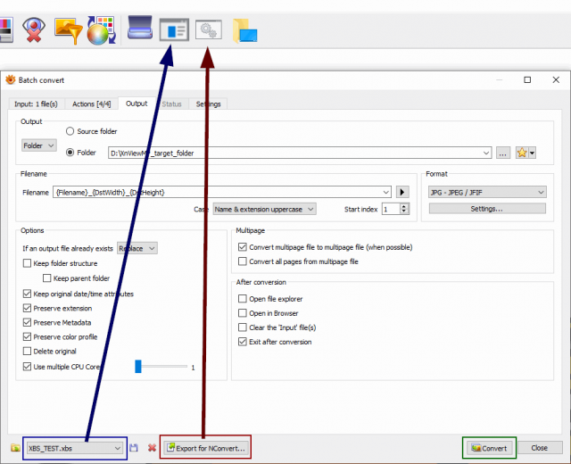

did a setup but it doesn't work :(
What I've done so far and I add some screenshots - for everyone who follows this idea:
I can add in Settings/Interface/ToolBar/... more than one "--COMMAND--" into (both) ToolBar. In this case it is the ViewMode.
Found as well in this window on the lower right "Set comman..." and "Set label.." option.
With "Set command..." I add *.xbs and *.bat saved files out of the "Batch Convert".
This is how it looks like in my "foo.bar" (my own ToolBar file):
<!...the important lines  ... >
_cmd_=XBS_TEST;D:/XBS_TEST.xbs;D:/XBS_TEST.xbs
_cmd_=BAT_TEST;D:/XN_BAT.bat;D:/XN_BAT.bat
_cmd_=;; <!... this is not assigned to commands ... >
The "Convert"-button in the "Batch Convert"-GUI does the whole job, but the two buttons in the "ToolBar" don't...

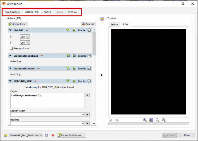

Button XBS_TEST.xbs (the xbs-file keeps all the options)
<?xml version="1.0" encoding="UTF-8"?><XnView_script version="1.0" name="XBS_TEST">
    <Set_DPI x="260" y="260" keep="false"/>
    <Automatic_contrast/>
    <Automatic_levels/>
    <IPTC-IIM_XMP id_40="Test" id_105="XnViewMP FTP" id_120="test image xnviewmp ftp" id_122="Test" keepKeywords="true" replace="false" mode="1"/>
    <Output folder="D:/XnViewMP_target_folder" filename="{Filename}_{DstWidth}_{DstHeight}" case="2" startIndex="1" format="JPEG">
        <Options overwrite="0" orgDate="true" keepMeta="true" keepICC="true" keepFolder="false" keepParentFolder="false" keepExtension="true" delOrg="false" multipage="true" allPages="false" openExplorer="false" openBrowser="false" clearItems="false"/>
        <JPEG quality="90" progressive="false" optimizeHuffman="false" rebuildThumb="true" orgQuality="true" DCTMethod="2" subSampling="0" smoothFactor="0"/>
    </Output>
</XnView_script>
...could work as intent but I cat run it... :(
Where I am wrong with _cmd_=XBS_TEST;D:/XBS_TEST.xbs;D:/XBS_TEST.xbs

The button opens the batch convert with the defined options but you have to start the conversion manually.

Hi Franky, aaaah, ok...
Yes, if I add the --COMMAND-- in the ToolBar/Browser Mode... it actully opens the "Batch Convert" menu ... and yes, then I can press the "Batch Convert" button to run the script / convertion...
Thx for that and sorry for my missunderstandings...
