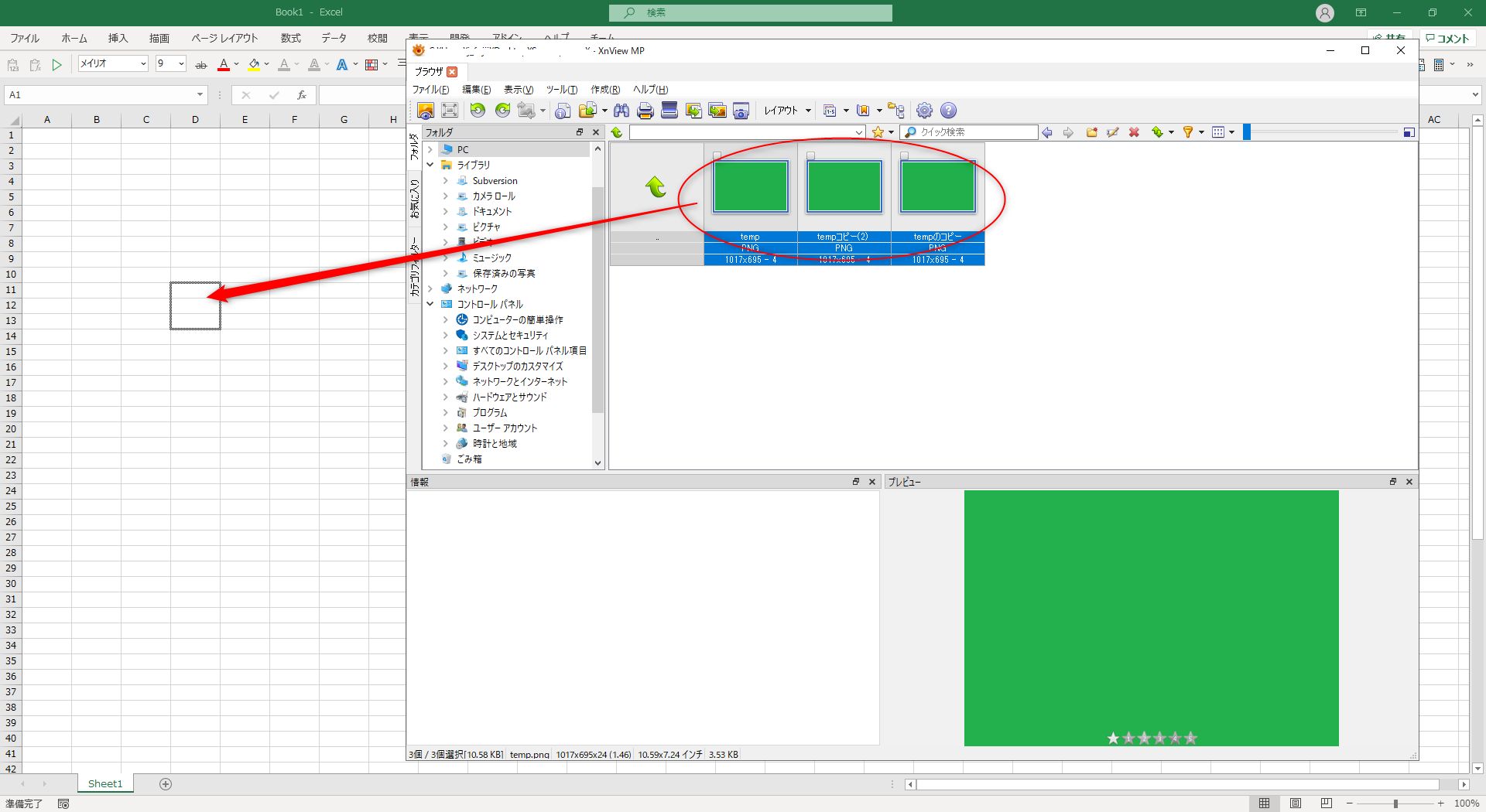

[DD.jpg] Drag&Drop img file XnView to Excel.
[Res.jpg] result.
- Posts: 48925
Re: Drag&Drop for Excel
in your screenshot, it works?
Nothing happens.
In 0.98.3, dragging now adds a border to the cell.
When I drop an image, it is inserted.
As soon as i drop it, the Excel window becomes active.
In 0.98.4, dragging does not put a border on the cell.
Nothing happens when I drop it.
The focus of the window does not move either.
The mouse cursor is just moving, but nothing happens.
Are you able to do D&D in 0.98.4?
