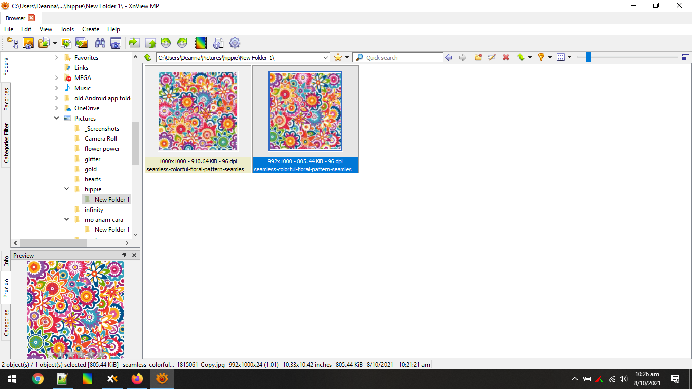

* Here you can see the difference before and after rotate. The same thing happens for flip.

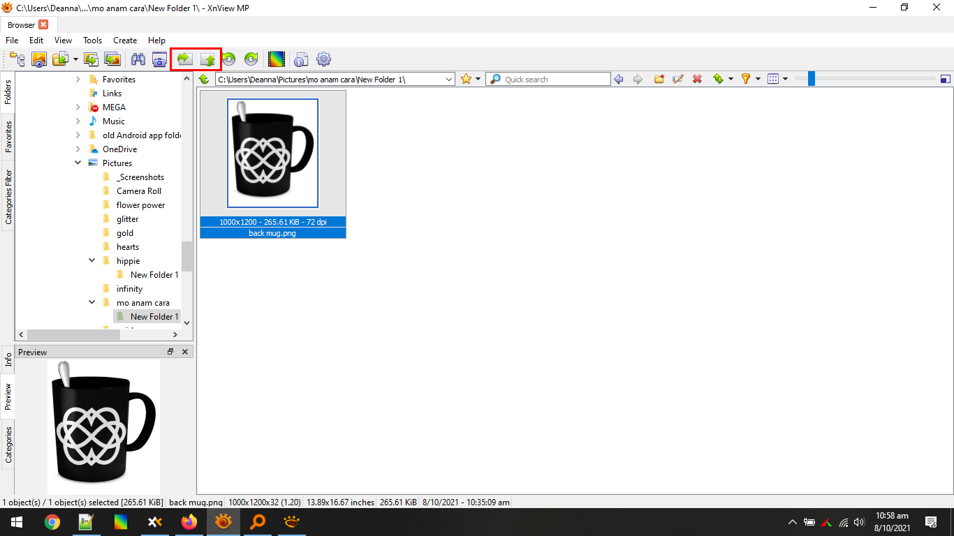

* No, I don't because that option is greyed out for non-jpg files.
XnTriq wrote: Mon Oct 04, 2021 5:45 pmAvailable commands in ToolsSettings…InterfaceToolBar:

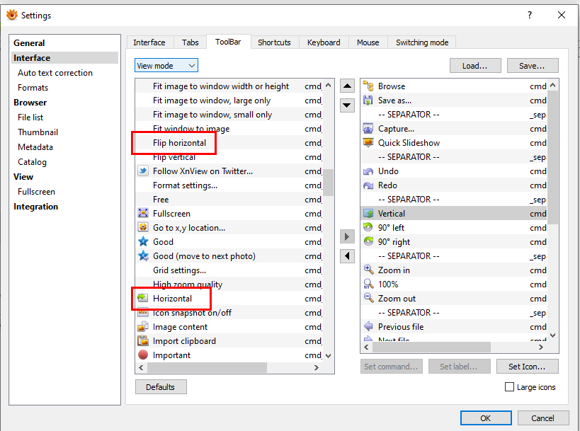

* In Browse, I have added the Flip horizontal and Flip vertical buttons to the toolbar but they don't appear to work for anything other than jpg files. I've tried png, webp, bmp, and ico. Here you can see for this png file the flip buttons are "active" but they don't work. (The rotate buttons do.)
* In View, I didn't realise there were two different sets of flip buttons (as you indicated above, one for Browse and one for View) but both are available in the Interface / ToolBar / View mode options (is that a bug?). Here you can see both horizontal buttons.
Initially, I had just added the same buttons as for Browse but they didn't work. I've now changed those to the other ones (Horizontal and Vertical) and they work.
* I was going to try adding custom buttons in Browse using the cmd_FlipH/cmd_FlipV commands but is that possible? When I add -- COMMAND -- and click Set command, all I get is a browse dialog to select a file. I can't see how to enter a command.
Is it possible to attach colorful-floral-pattern-seamless-background-vector-1815061.jpg (1000×1000 pixels) so I can do some tests?
kiwichick wrote: Thu Oct 07, 2021 10:22 pm* In View, I didn't realise there were two different sets of flip buttons (as you indicated above, one for Browse and one for View) but both are available in the Interface / ToolBar / View mode options.
You're right. I've since edited my previous post accordingly.

So It's not a bug that they don't work on other image formats. (Come to think of it, there should be an error message, though.)
Activating Use lossless rotation (if possible) in ToolsSettings…BrowserMisc.Rotation should make the following commands lossless when used on JPEGs:
I realise it's not a bug that they don't work on other image formats but why are the buttons active for other image formats? And that wasn't what I was referrring to when I asked if it was a bug. I was referrring to the fact that Flip Vertical/Flip Horizontal and Vertical/Horizontal were all available in View options. You've confirmed it's not a bug but it does have me asking why, then, aren't the Vertical/Horizontal buttons available in Browse options? How do I get Vertical/Horizontal flip for non-jpg files in Browse?

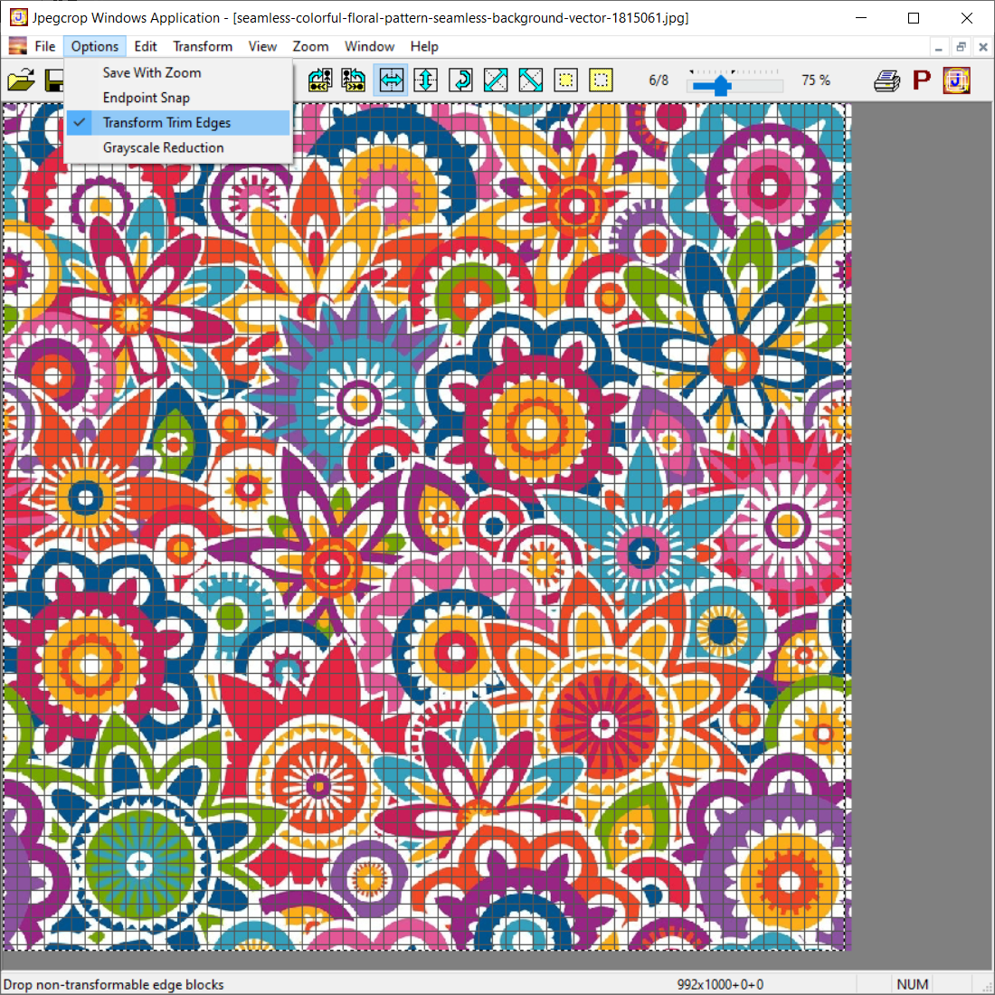

Chroma sub-sampling of seamless-colorful-floral-pattern-seamless-background-vector-1815061.jpg is 2x2,1x1,1x1, which means that the MCU size is 16×16 pixels. Because its dimensions (1000×1000 pixels) are not a multiple of 16, partial MCUs (i.e. non-transformable edge blocks) are discarded/trimmed/dropped by XnView when a lossless flip/mirror or rotate operation/transformation is executed (62×16=992):
Tools → Settings… → General → General → Reset all confirm prompts
  • cmd_lhflip → 992×1000 pixels
  • cmd_lvflip → 1000×992 pixels
https://www.jpegclub.org/jpegcrop.zip
https://www.jpegclub.org/jpegcrop/index.html wrote:Transform Trim Edges
Drop non-transformable edge blocks.
Here is what the IJG v9 usage.txt file says about this switch:
The transpose transformation has no restrictions regarding image dimensions. The other transformations operate rather oddly if the image dimensions are not a multiple of the iMCU size (usually 8 or 16 pixels), because they can only transform complete blocks of DCT coefficient data in the desired way.
jpegtran's default behavior when transforming an odd-size image is designed to preserve exact reversibility and mathematical consistency of the transformation set. As stated, transpose is able to flip the entire image area. Horizontal mirroring leaves any partial iMCU column at the right edge untouched, but is able to flip all rows of the image. Similarly, vertical mirroring leaves any partial iMCU row at the bottom edge untouched, but is able to flip all columns. The other transforms can be built up as sequences of transpose and flip operations; for consistency, their actions on edge pixels are defined to be the same as the end result of the corresponding transpose-and-flip sequence.
For practical use, you may prefer to discard any untransformable edge pixels rather than having a strange-looking strip along the right and/or bottom edges of a transformed image. To do this, add the -trim switch.
Obviously, a transformation with -trim is not reversible, so strictly speaking jpegtran with this switch is not lossless. Also, the expected mathematical equivalences between the transformations no longer hold. For example, "-rot 270 -trim" trims only the bottom edge, but "-rot 90 -trim" followed by "-rot 180 -trim" trims both edges.

As far as I can tell, there's no way to add buttons for cmd_FlipH and/or cmd_FlipV to the toolbar of browse mode. I even tried to add these commands by creating a toolbar preset (foo.bar) with a text editor…
[Browser]
cmd_flipM
cmd_flipH
cmd_flipV
cmd_lhflip
cmd_lvflip
[View]
cmd_flipM
cmd_flipH
cmd_flipV
cmd_lhflip
cmd_lvflip
… and importing it via ToolsSettings…InterfaceToolBarLoad… – to no avail.

Windows Explorer and Windows Photos rotate the 1000x1000 image losslessly, without removing any pixels.
Couldn't XnView do the same, or is such behavior wrong somehow (against jpeg specs, maybe)?
I don't need to rotate such images often (I can use Explorer for those rare cases), so mostly I'm just curious.
Posts: 6517
Re: Lossless flip/rotate
Lewis wrote: Wed May 28, 2025 12:36 pm Windows Explorer and Windows Photos rotate the 1000x1000 image losslessly, without removing any pixels.
It depends on the JPEG's chroma subsampling:
https://en.wikipedia.org/wiki/JPEG#Lossless_editing wrote:Rotations where the image is not a multiple of 8 or 16, which value depends upon the chroma subsampling, are not lossless. Rotating such an image causes the blocks to be recomputed which results in loss of quality.
https://www.google.com/search?q=chroma+subsampling+mcu+size wrote:
  • 4:4:4 (no subsampling):
    An MCU is 8x8 pixels. In this case, Y, Cb, and Cr (luminance and chrominance components) are all sampled at the full resolution.
  • 4:2:2 (horizontal subsampling):
    An MCU is 16x8 pixels. The Y component is sampled at full resolution, while Cb and Cr are halved in the horizontal direction.
  • 4:2:0 (horizontal and vertical subsampling):
    An MCU is 16x16 pixels. The Y component is sampled at full resolution, while Cb and Cr are halved in both horizontal and vertical directions.
I use Jpegcrop to determine the MCU size.
