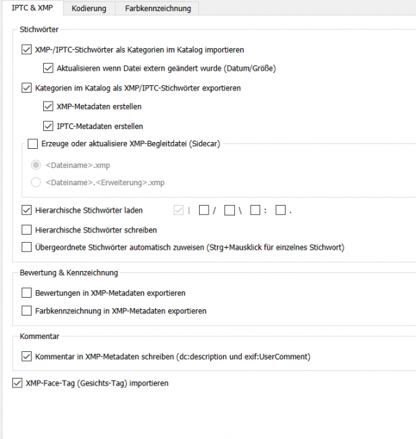

not normal, could you post a screenshot of settings>Metadata? and you tag only jpeg files?

Here my settings.
