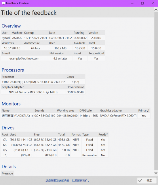

Yeah I got a better pc so it's faster...a little bit
btw this debug screen was generated by the in-app feedback button by screentogif

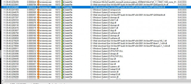

promon shows that xnview takes tons of time loading some dlls Here's the full log (this run takes 8 seconds btw):

it seems that libQt5Webkit is slow to load... And XnConvert delay? (it doesn't use WebKit)

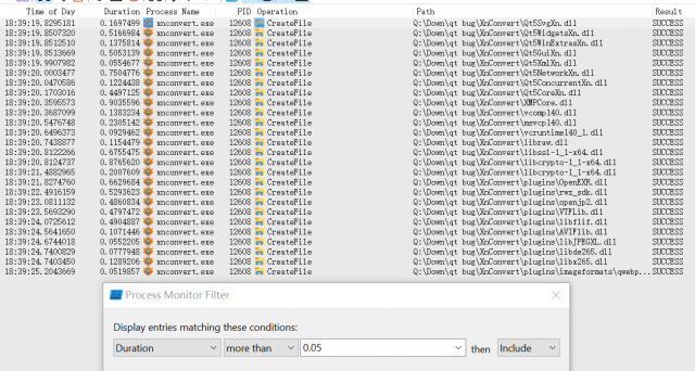

XnConvert is a separate application which consists of XnView's batch processing engine (no view and no browse mode etc.). XnConvert is also based on Qt, but comes with less DLLs. v1.94.0 is the latest release.

7 secondsXnTriq wrote: Tue Nov 16, 2021 10:30 amThank you for your patience and continued support, BK201BK201 wrote: Tue Nov 16, 2021 9:28 amTCPView didn't show any connection from xnview
