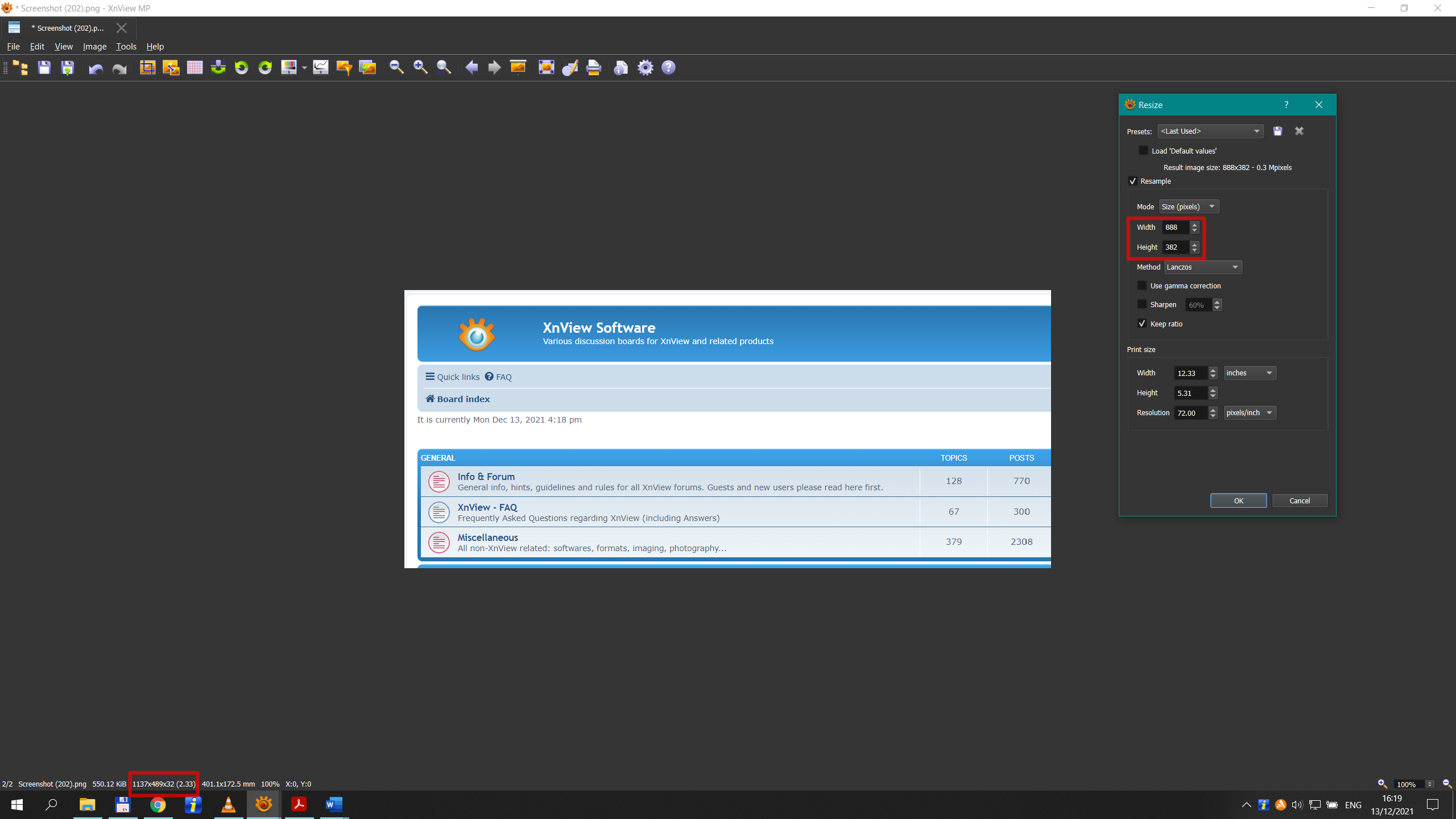

Sometimes shows wrong dimension of an image when performing resizing.
Dimensions of the image in the bottom left corner are correct, but in the resizing menu they are completely off.
Wrong image dimensions when resizing

This known issue 0.99.4: Resize dialog has bug ?

you have not last used dimensions?

The problem is that resize dialog shows last used dimensions, not current ones. Which is annoying because you have to click Resample every time, otherwise image may lose original proportions.

you have now 'Load default'rogi wrote: Mon Dec 13, 2021 2:22 pm The problem is that resize dialog shows last used dimensions, not current ones. Which is annoying because you have to click Resample every time, otherwise image may lose original proportions.

Uh, OK. I got it. I have to select "Default" preset from dropdown and check "Load Default values" option. Thank you!
