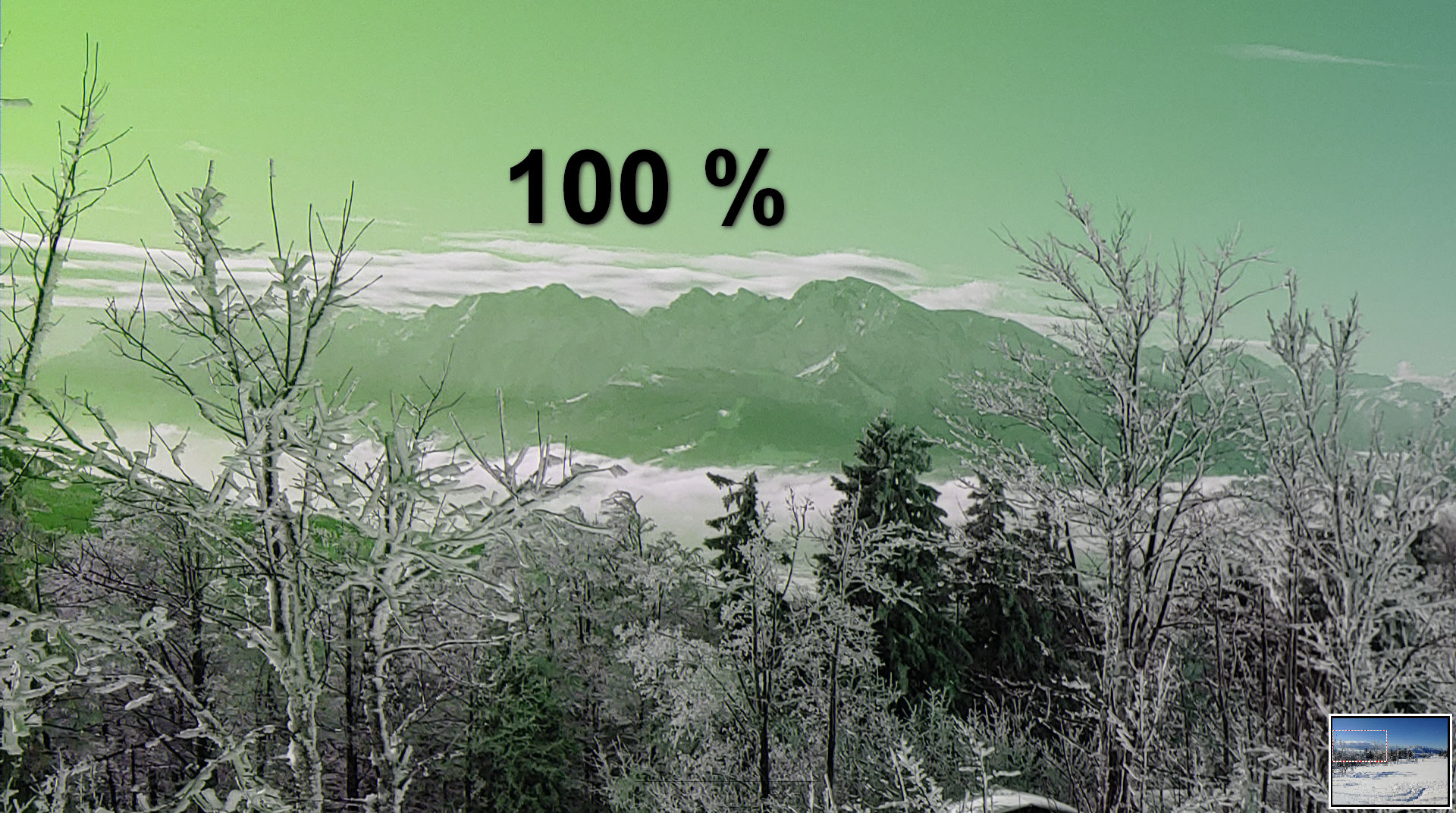

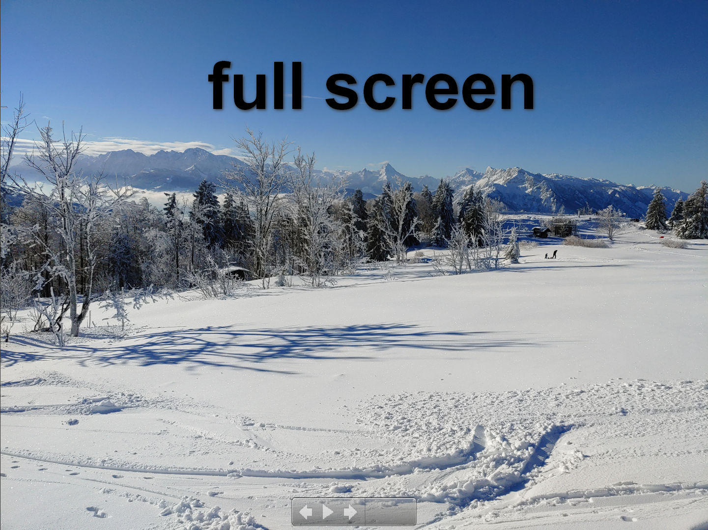

Hi!
There is a problem with colors on XnViewMP 0.99.7.
When I get photos from the App 'Open Camera", they have no color profile, which is generally no problem. Looking at full screen, colors are perfectly ok.
But looking at 100%, colors are wrong! All other zoom percentages are fine, only 100% is wrong.
It is not a matter of any settings in the ICC tab.
With older version XnViewMP 0.94.1 there is no problem and the colors an fine! And with any other viewer.
Thanks!

Posts: 46426
Re: Incorrect Colors at 100%
on Windows?

Posts: 46426
what do you have in settings>View - high zoom?

Posts: 46426
with 'never', you have this problem??

I tested again (with 0.99.7 64bit portable):
'Never' works
'Zoom-in' works
'Zoom-out' does not work
'Zoom-out & Zoom-in' does not work
Version 0.99.1.0 works with all settings
Posts: 46426
i can't reproduce, which method?

In viewer I am zooming with shortcut to 'cmd_zoom100' or 'right mouse zoom 100%'.
Maybe it is a matter of my 'Intel HC 630' graphic card. But it is no issue any more, because it works fine with the setting 'Never' or 'Zoom-in'. No need for further research.
Thank You
Posts: 46426
i need to understand. which filter, bilinear?

I am using Bilinear. But it is the same fault with all others (Bicubic, Spline, Lanczos)
Posts: 46426
Strange, and you can reproduce always and with all picture?
Do you use windows font scaling?

You found it, You are right!
I used a custom scaling of 140%, which was apparently the reason for the bad colors.
Now I tried 125% (one of the Windows suggested defaults) and everything is OK, perfect colors!
I have another Windows 10 PC, where I use 250% (also one of the Windows defaults): perfect colors!
Posts: 46426
Re: Incorrect Colors at 100% Zoom
ok, thanks i'll check
