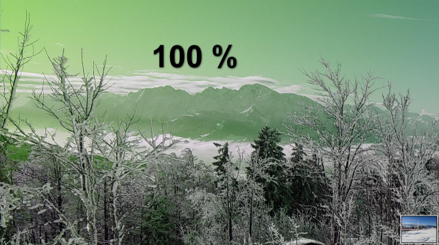

There is a problem with colors on XnViewMP 0.99.7.

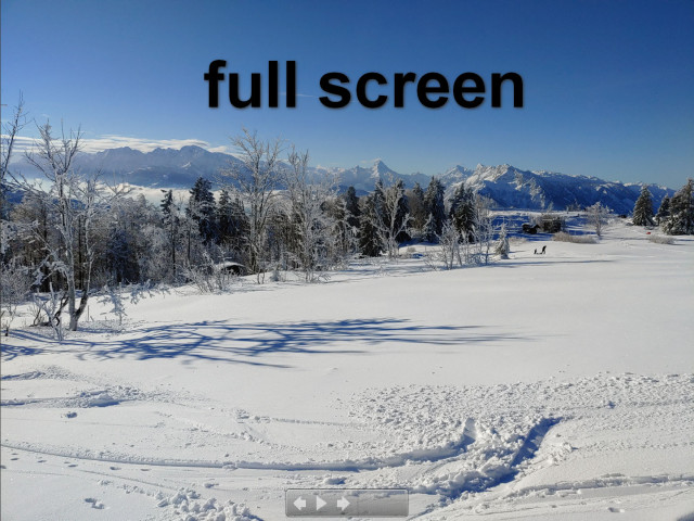

When I get photos from the App 'Open Camera", they have no color profile, which is generally no problem. Looking at full screen, colors are perfectly ok.
But looking at 100%, colors are wrong! All other zoom percentages are fine, only 100% is wrong.
