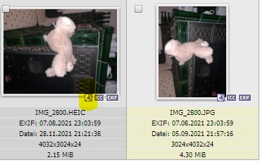

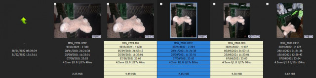

Some HEIC files are displayed in the browser with incorrect rotation.
It is noticeable that the rotation symbol (highlighted in yellow) is displayed,
In Windows Explorer the files are displayed correctly rotated.

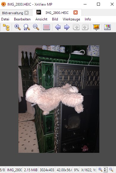

In View mode the file is displayed correctly.
Moving the files in Windows Explorer solves the problem sometimes (but not always).
Therefore, it should not be a bug of the affected HEIC files, moreover, they are displayed correctly in WIndows Explorer.

It is noticeable that in the preview of the HEIC files the yellow marked symbol appears when the rotation is wrong.
