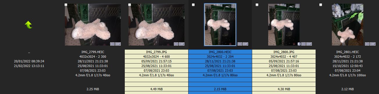

Some HEIC files are displayed in the browser with incorrect rotation.
It is noticeable that the rotation symbol (highlighted in yellow) is displayed,

In View mode the file is displayed correctly.

But when restarting XnView again, some (not all) HEIC-thumbnails were rotated wrong again.
It is noticeable that in the preview of the HEIC files the yellow marked symbol appears when the rotation is wrong.
