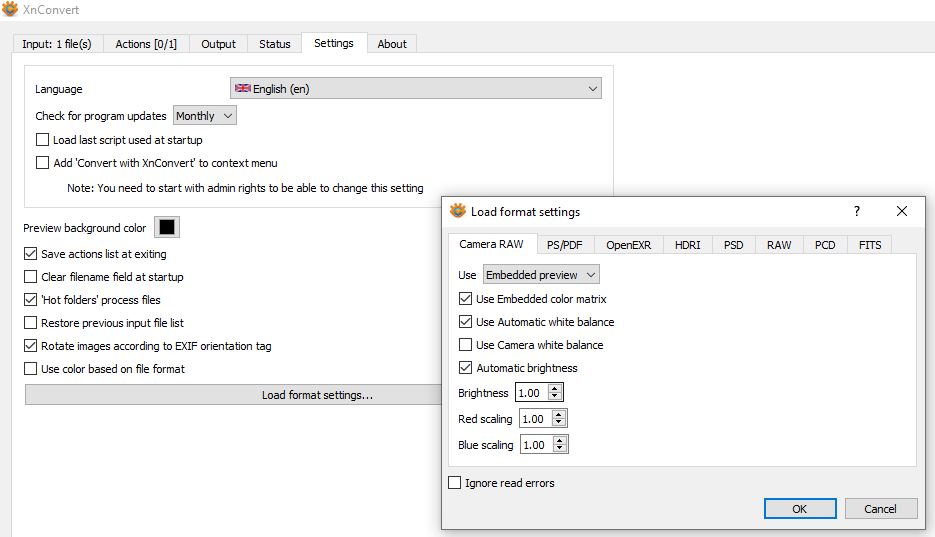

I have been trying to convert .csv files into .tiff or .png images.
I noticed XnConverter does not read .csv files, so I converted them to .ps and .prn. For that, I also installed Ghostscript as recommended.
However, I could not activate it on the XnConvert as indicated on the website, there is no option to do that through the path mentioned here:
https://www.xnview.com/wiki/index.php?title=Ghostscript
This is what I get (Fig. 1)
When trying to read the .ps or .prn files, I get the message that it is not a picture (Fig. 2)
I tried to do the opposite, too. I converted a .tiff image into a .csv and then a .ps, but it still does not recognize the files it created.
Could you help me find a solution for these conversions?

Re: CSV to TIFF or PNG conversion
CSV as in Comma Separated Value?
Have you checked whether you are able to export CSV files to PDF format from any application you have that can view CSV files? If not, there are freeware utilities such as Cute PDF that can create a PDF file from any file that can be printed.
Are you able to open a simple vector format PDF file, such as a text page exported from Word as a PDF, to confirm that you can open valid PDF files in XnConvert as currently configured?
Otherwise, an online search 'convert csv pdf' might be productive, various online converters and other tools shown.
Edit:
Or, having the Camera RAW settings window open in your screenshot, are your CSV files a RAW format?

1. CSV as in Comma Separated Value? -- Yes, that's right
2. Have you checked whether you are able to export CSV files to PDF format from any application you have that can view CSV files? If not, there are freeware utilities such as Cute PDF that can create a PDF file from any file that can be printed.
-- Yes, XnConvert is reading PFD files, but since I have a spreadsheet with thousands of numbers, converting to PDF is not really what I need. The only match I found between my csv file and XnConverter is ps or prn formats. And XnConverter is not reading them, so I cannot convert the csv into images.
