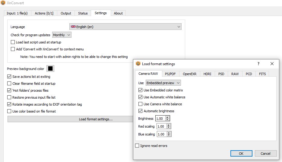

I have been trying to convert .csv files into .tiff or .png images.
I noticed XnConverter does not read .csv files, so I converted them to .ps and .prn. For that, I also installed Ghostscript as recommended.
However, I could not activate it on the XnConvert as indicated on the website, there is no option to do that through the path mentioned here:
https://www.xnview.com/wiki/index.php?title=Ghostscript
This is what I get (Fig. 1)

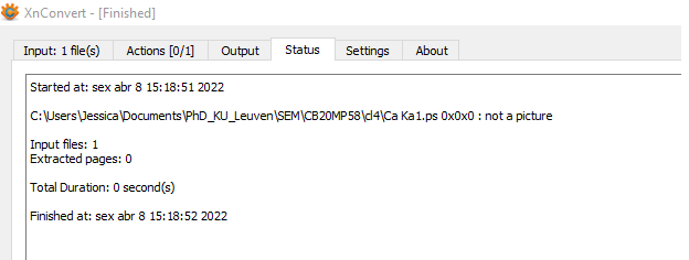

When trying to read the .ps or .prn files, I get the message that it is not a picture (Fig. 2)
I tried to do the opposite, too. I converted a .tiff image into a .csv and then a .ps, but it still does not recognize the files it created.
Could you help me find a solution for these conversions?
