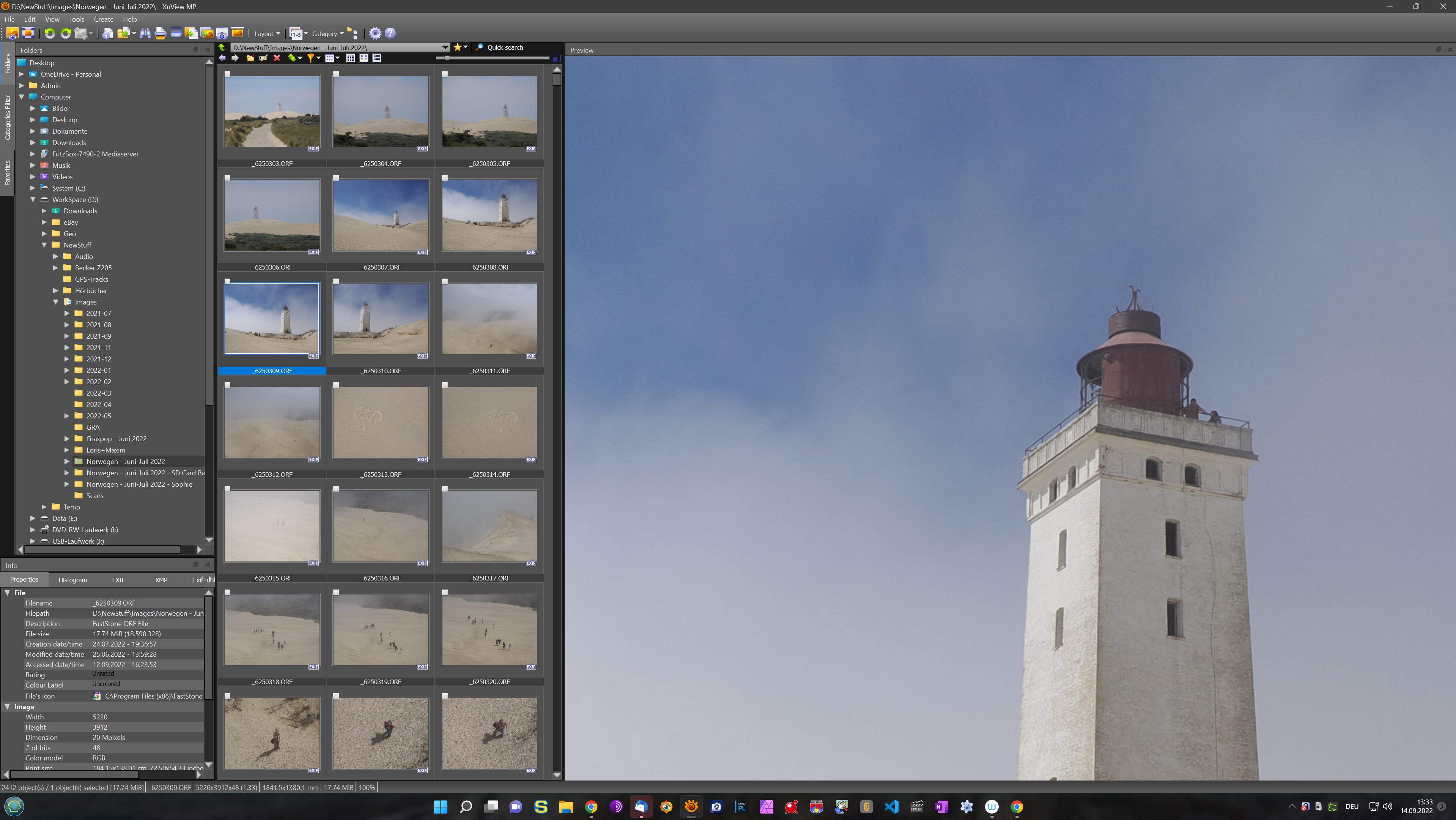

I can notice a strange behavior when I zoom into a photo in the preview area.
Up to a magnification of 100% the center point of the photo keeps more or less the same. Of cause there is a change between a magnification where the complete photo is visible and a magnification where only a part of the photo can be shown in the preview area.
At a magnification of 142% there is a significant change and only a little part of the photo is visible any more, looks like the photo is shifted to the upper left corner. Increasing the magnification further the photo is shown with the same center point as before. Generally it seems that the center point for the magnification is depending on the mouse position ...
Hope I could describe this in an understandable way.
This behavior might depend on the monitor resolution??? I use a 4k monitor at a resolution of 3840 x 2160.
Could you please check this?!? At least for me the critical magnificationm is 142%!

I just figured out that this behavior only happens when viewing raw files of my Olympus OMD-EM1II/III and the OMDS OM-1.
Zooming into raw files of my former Olympus OMD EM-5 II and my Nikon D700 work fine! tiff and jpg also work!

@Helmut: Viewing for example tif or jpg files or raw files of my Olympus OMD EM-5 II and Nikon D700 it works exactly the way you described it.
I can notice the 'strange behavior' only when viewing orf files of my Olympus OMD-EM1II/III and the OMDS OM-1!!!
@Pierre: Instead of posting some screenshots, wouldn't it be easier for you if I upload a orf file???

here are some screenshots of the behavior with zooming into an ORF of an OM-1 at 26%, 100%, 142% and 200%. The mouse pointer always points to the top of the tower expect the step from 142 to 200% where it wasn't in the visible area ...

Thank you for your posting screenshots, Ludger. This looks really strange and like a bug.
I've tried myself to reproduce the problem but didn't succeed. I think it would be good and helpful if you uploaded and ORF file which has problems when zooming. My guess is that it has something to do with screen resolution and or Windows' scaling. But let's see whether the bug can be reproduced with the ORF file that you'll provided.LuNik wrote: Tue Sep 13, 2022 7:41 am... @Pierre: Instead of posting some screenshots, wouldn't it be easier for you if I upload a orf file???

I could now find out that the behavior has something to do with the Setting "High Zoom Quality" in the Settings|View dialog when using the embedded jpg for the preview.
If I switch to "Never" everything works fine!!!
Beside the described behavior changing this to other settings sometimes a strange pattern at a zoom level of 51% occurs!!! At all other zoom levels the photo looks ok!!! At 142% it is shifted to the upper left (at some settings of "High Zoom Quality" for example "Zoom-out"/"Bicubic").
As I said before: If I switch to "Never" everything works fine!!!
What exactly does "High Zoom Quality" do??? Changed this setting so often now ... what is the default?

SORRY .. . When I checked out all those options at "Settings|View" I accidentally changed "Pixel ratio". That caused the strange pattern!!!
So, just to clarify: The behavior of the preview when zooming into a photo in ORF format (OM-D Em1II/III and OM-1) seems to have something to do with the setting of "High Zoom Quality". When setting this to "Never" it works fine otherwise the center point somehow shifts to the upper left.
Sorry for the confusion!!!

If you change high zoom quality, you have the strange behavior?? 'Camera RAW' has which value?

>>>If you change high zoom quality, you have the strange behavior??<<<
YES!
Thanks for your efforts!!!!!!!!!!!!!
Ludger
YES!
- "Never"
works well
- "Zoom-out", "Zoom-in" and "Zoom-out& Zoom-in"
at 142% only a little part of the photo is visible any more, looks like the photo is shifted to the upper left corner. From 200% to 1600%
it works normal again. In some (rare) cases the effect starts when zooming at 200%. Perhaps depending on the position of the mouse pointer???
