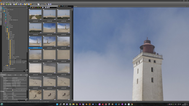

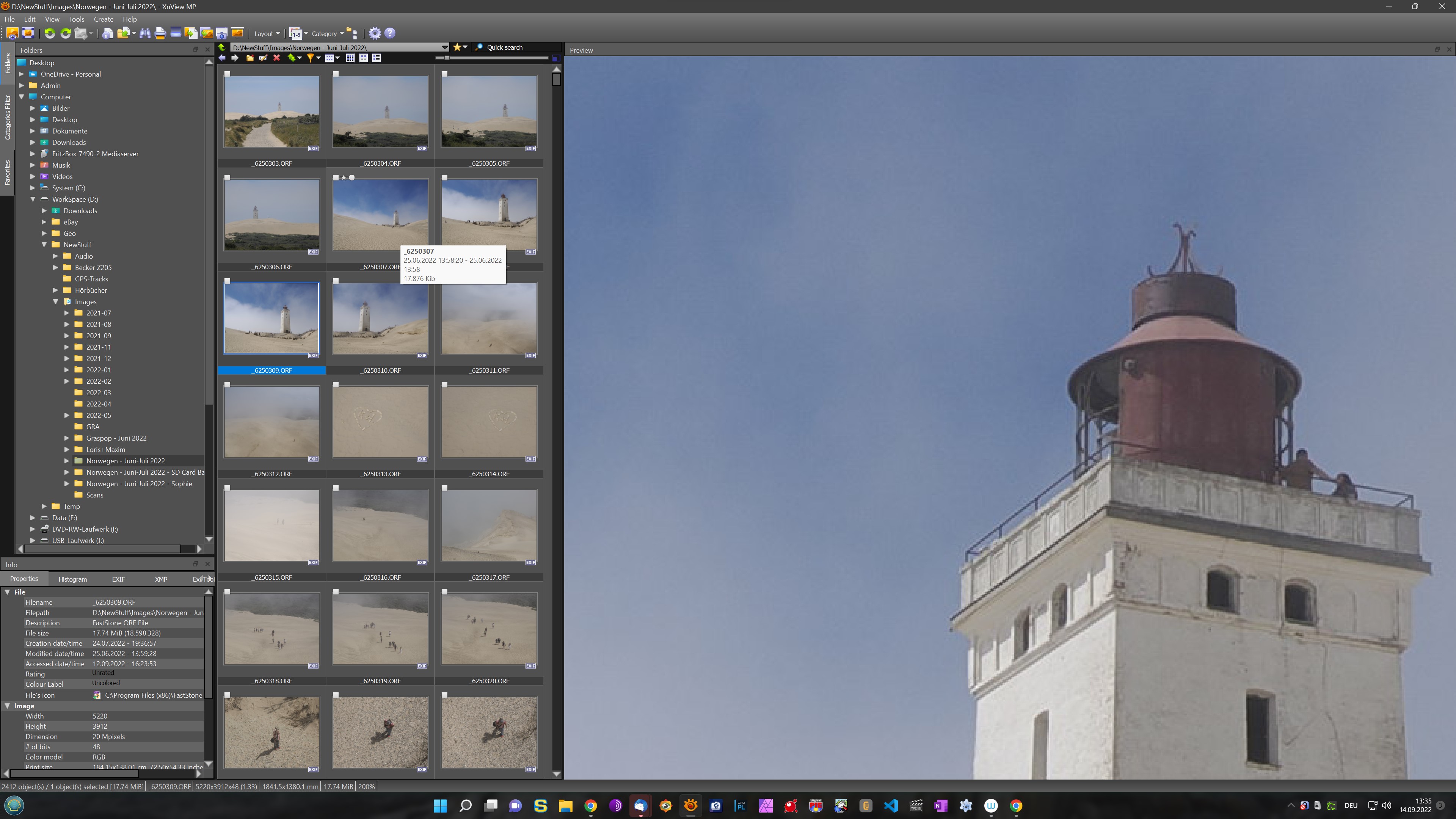

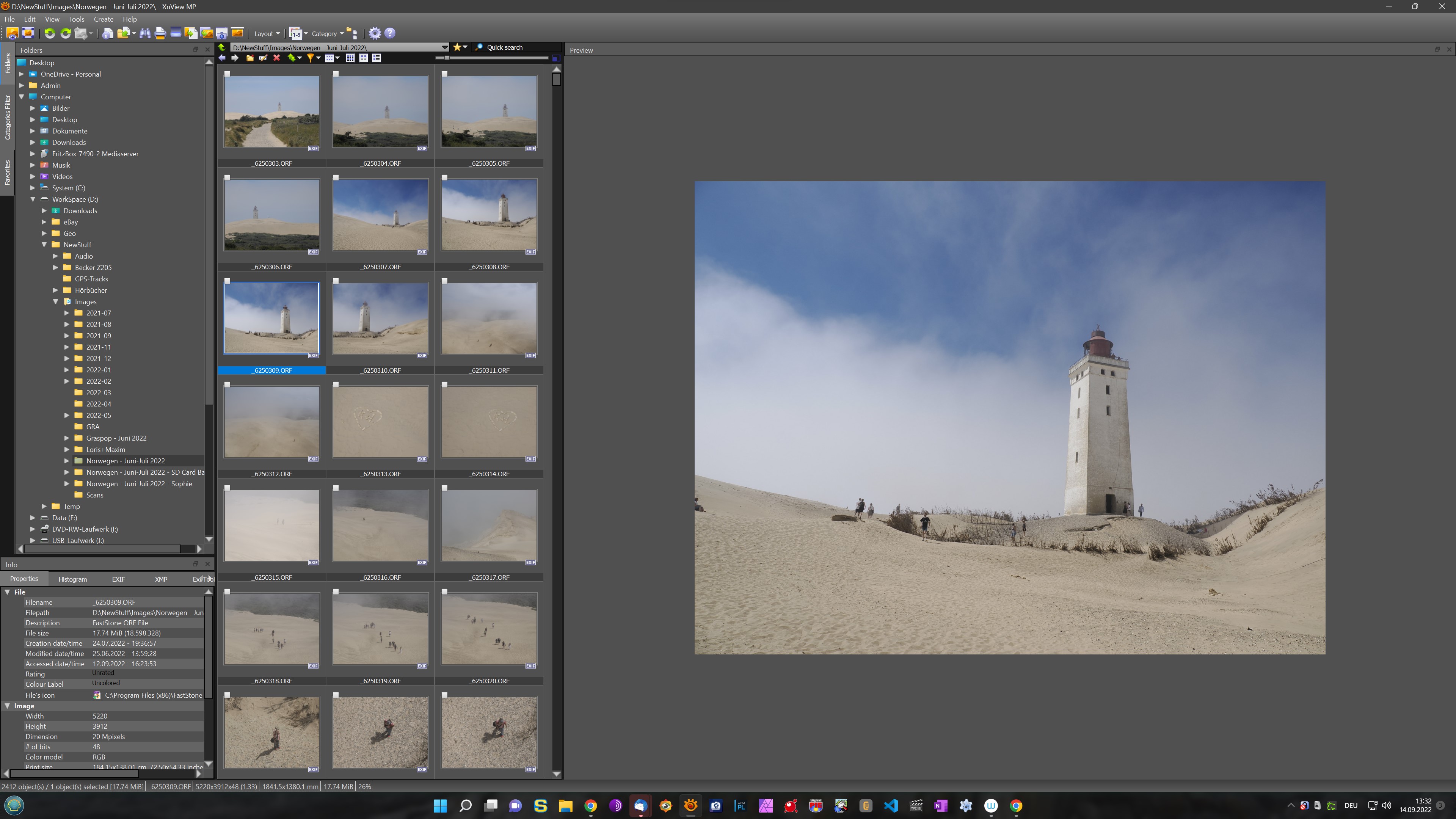

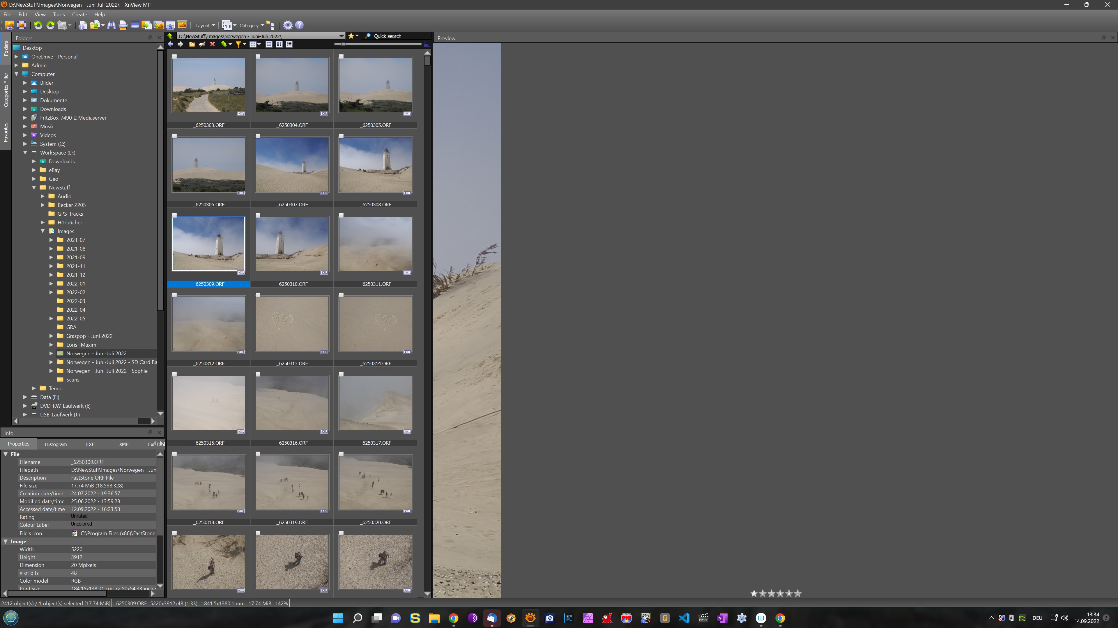

here are some screenshots of the behavior with zooming into an ORF of an OM-1 at 26%, 100%, 142% and 200%. The mouse pointer always points to the top of the tower expect the step from 142 to 200% where it wasn't in the visible area ...
Best regards
Ludger
Best regards
Ludger

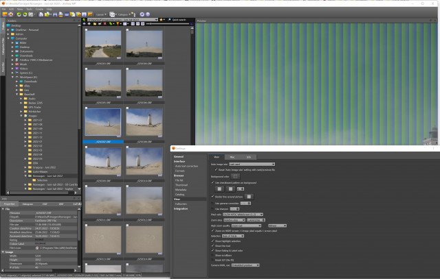

I could now find out that the behavior has something to do with the Setting "High Zoom Quality" in the Settings|View dialog when using the embedded jpg for the preview.
If I switch to "Never" everything works fine!!!
Beside the described behavior changing this to other settings sometimes a strange pattern at a zoom level of 51% occurs!!! At all other zoom levels the photo looks ok!!! At 142% it is shifted to the upper left (at some settings of "High Zoom Quality" for example "Zoom-out"/"Bicubic").
As I said before: If I switch to "Never" everything works fine!!!
What exactly does "High Zoom Quality" do??? Changed this setting so often now ... what is the default?

SORRY .. . When I checked out all those options at "Settings|View" I accidentally changed "Pixel ratio". That caused the strange pattern!!!
So, just to clarify: The behavior of the preview when zooming into a photo in ORF format (OM-D Em1II/III and OM-1) seems to have something to do with the setting of "High Zoom Quality". When setting this to "Never" it works fine otherwise the center point somehow shifts to the upper left.
Sorry for the confusion!!!
Ludger
