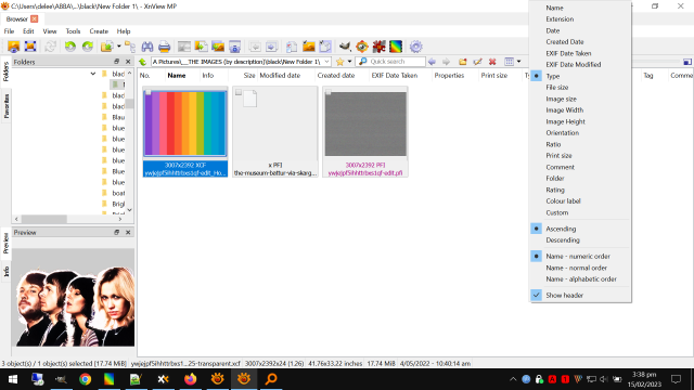

Can someone please tell me what is happening with these files? The first one is an xcf file used by GIMP and the other two are pfi files used by PhotoFiltre. They all contain layers.
1) XCF file:
XnView displays one layer as the thumbnail but a different one as the preview.
2) PFI files:
The first pfi file is being treated as an 'other' filetype whereas the second one is recognised as a filetype.
3) Why are the xcf files listed before the pfi files when I have the sort order as ascending?
Thumbnail and Preview not displaying correctly

- Posts: 48913
Re: Thumbnail and Preview not displaying correctly
Thumbnail doesn't use layers but embedded image so you can see a differencekiwichick wrote: Wed Feb 15, 2023 2:51 am 1) XCF file:
Yes i'll check2) PFI files:
XCF has file type 'Gimp', and PFI 'Photofiltre'3) Why are the xcf files listed before the pfi files when I have the sort order as ascending?
Thanks, that explains it.xnview wrote: Wed Feb 22, 2023 9:38 am Thumbnail doesn't use layers but embedded image so you can see a difference
Thanks, I look forward to hearing about what you discover.Yes i'll check
Ah yes, my mistake, I didn't realise I was sorting by Type instead of Name.XCF has file type 'Gimp', and PFI 'Photofiltre'
