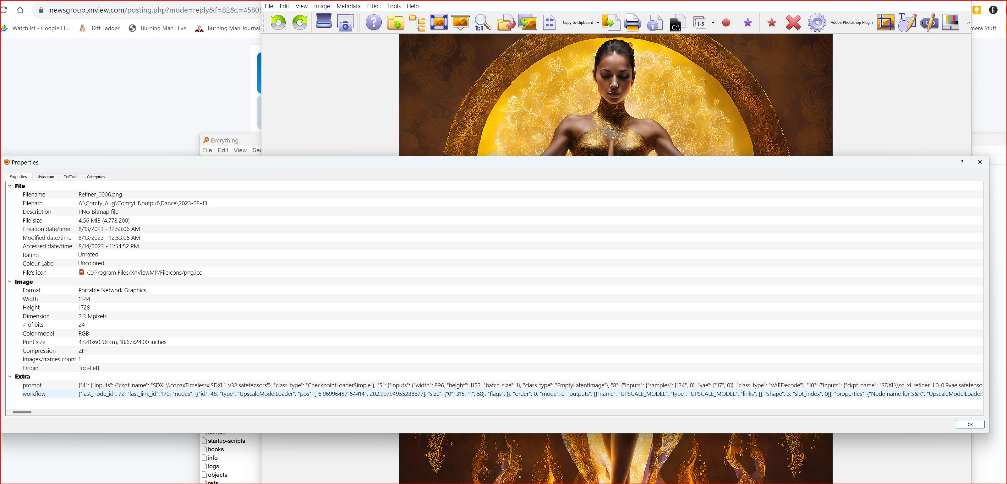

Here's a screen shot saved as jpg showing the XnView with one of the generative images in view and the properties window open via using alt+enter
The information that is important to me is at the bottom in the extras section.

In that png image that I just was able to upload you can view the properties/Extras and see there are two sections - Prompt and Workflow that contain the useful information.
Promt is maybe the most useful and it's a big line of stuff - see pasted below:
Of that huge list, the most important probably are the ckpt models and the text input:
{"inputs": {"ckpt_name": "SDXL\\AllAround\\juggernautXL_version5.safetensors"}
{"inputs": {"text": "beautiful geometric patterns of very fine color lines are projected onto an abstracted dark female form, full body in a dynamic dance pose, revealing the secrets of life in fine detail. In style of ••• SPAM ••• and style of Kehinde Wiley and Gustav Klimt\n\n"}
But it would be amazing to be able to search a set of images for ckpt model or any of the other input terms like Lora
and if there were a way to display these values in their own box, that would be an incredible resource to those using Stable Diffusion since there isn't any easy way currently to manage catalogs of images with this information
prompt contains:
{"1": {"inputs": {"samples": ["2", 0], "vae": ["9", 0]}, "class_type": "VAEDecode"}, "2": {"inputs": {"seed": ["20", 0], "cfg_scale": 17.6, "sampler": "dpmpp_2m", "scheduler": "karras", "start_at_step": 0, "base_steps": 83, "refiner_steps": 21, "detail_level": 1.0, "detail_from": "penultimate_step", "noise_source": "CPU", "auto_rescale_tonemap": "enable", "rescale_tonemap_to": 11.0, "model_model": ["136", 0], "model_refiner": ["3", 0], "CONDITIONING_model_pos": ["133", 0], "CONDITIONING_model_neg": ["135", 0], "CONDITIONING_refiner_pos": ["132", 0], "CONDITIONING_refiner_neg": ["134", 0], "latent_image": ["96", 0]}, "class_type": "KSamplerSDXLAdvanced"}, "3": {"inputs": {"ckpt_name": {"content": "SDXL\\OEM\\sd_xl_refiner_1.0_0.9vae.safetensors", "image": null}, "example": "[none]"}, "class_type": "CheckpointLoader|pysssss"}, "4": {"inputs": {"image": "fingerprint-plus (2).jpg", "choose file to upload": "image"}, "class_type": "LoadImage", "is_changed": ["46b83e12b1b6c0b29054f4d0182a2a202df93e8b82afabdb9c9748ca97ce346a"]}, "5": {"inputs": {"pixels": ["7", 0], "vae": ["60", 0]}, "class_type": "VAEEncode"}, "6": {"inputs": {"width": ["33", 0], "height": ["33", 1], "method": "lanczos", "images": ["61", 0]}, "class_type": "ImageTransformResizeAbsolute"}, "7": {"inputs": {"intensity": 1.0, "scale": 100.0, "temperature": 0.0, "vignette": 0.0, "image": ["6", 0]}, "class_type": "FilmGrain"}, "9": {"inputs": {"vae_name": "diffusion_pytorch_model_XL09_RefinerVAE.safetensors"}, "class_type": "VAELoader"}, "10": {"inputs": {"lora_name": {"content": "SDXL\\GraphicD\\LeParc_AI_LoRA_XL_v2.1-000020.safetensors", "image": "loras/SDXL\\GraphicD\\LeParc_AI_LoRA_XL_v2.1-000020.png"}, "strength_model": 0.96, "strength_clip": 0.99, "example": "[none]", "model": ["39", 0], "clip": ["39", 1]}, "class_type": "LoraLoader|pysssss"}, "11": {"inputs": {"model_name": "Best\\4x_UniversalUpscalerV2-Sharper_103000_G.pth"}, "class_type": "UpscaleModelLoader"}, "12": {"inputs": {"upscale_by": 3.0, "seed": 413547168058634, "steps": 65, "cfg": 21.200000000000003, "sampler_name": "dpmpp_2m_sde_gpu", "scheduler": "exponential", "denoise": 0.4, "mode_type": "Chess", "tile_width": 1024, "tile_height": 1024, "mask_blur": 8, "tile_padding": 32, "seam_fix_mode": "None", "seam_fix_denoise": 1.0, "seam_fix_width": 64, "seam_fix_mask_blur": 8, "seam_fix_padding": 16, "force_uniform_tiles": "enable", "image": ["77", 0], "model": ["119", 0], "positive": ["133", 0], "negative": ["135", 0], "vae": ["9", 0], "upscale_model": ["11", 0]}, "class_type": "UltimateSDUpscale"}, "13": {"inputs": {"vae_name": "diffusion_pytorch_model_XL09_BaseVAE.safetensors"}, "class_type": "VAELoader"}, "14": {"inputs": {"model_name": "bbox/face_yolov8m.pt"}, "class_type": "UltralyticsDetectorProvider"}, "15": {"inputs": {"threshold": 0.5, "dilation": 10, "crop_factor": 2.0, "drop_size": 10, "bbox_detector": ["14", 0], "image": ["98", 0]}, "class_type": "BboxDetectorSEGS"}, "16": {"inputs": {"model_name": "sam_vit_l_0b3195.pth", "device_mode": "AUTO"}, "class_type": "SAMLoader"}, "17": {"inputs": {"detection_hint": "center-1", "dilation": 0, "threshold": 0.93, "bbox_expansion": 0, "mask_hint_threshold": 0.7, "mask_hint_use_negative": "False", "sam_model": ["16", 0], "segs": ["15", 0], "image": ["98", 0]}, "class_type": "SAMDetectorCombined"}, "18": {"inputs": {"segs": ["15", 0], "mask": ["17", 0]}, "class_type": "Segs & Mask"}, "19": {"inputs": {"guide_size": 1024.0, "guide_size_for": false, "max_size": 1024.0, "seed": ["20", 0], "steps": 35, "cfg": 8.5, "sampler_name": "dpmpp_2m_alt", "scheduler": "karras", "denoise": 0.25, "feather": 5, "noise_mask": true, "force_inpaint": true, "wildcard": "laughing", "image": ["98", 0], "segs": ["18", 0], "model": ["39", 0], "clip": ["39", 1], "vae": ["13", 0], "positive": ["21", 0], "negative": ["135", 0]}, "class_type": "DetailerForEachDebug"}, "20": {"inputs": {"seed": 165369254788705}, "class_type": "CR Seed"}, "21": {"inputs": {"conditioning_1": ["22", 0], "conditioning_2": ["133", 0]}, "class_type": "ConditioningCombine"}, "22": {"inputs": {"text": "laughing, professional face, photography, detailed, macro crisp quality ", "clip": ["39", 1]}, "class_type": "CLIPTextEncode"}, "23": {"inputs": {"add_noise": "disable", "noise_seed": ["20", 0], "tile_width": 1024, "tile_height": 1024, "tiling_strategy": "random", "steps": 115, "cfg": 16.0, "sampler_name": "dpmpp_2m_sde_gpu", "scheduler": "exponential", "start_at_step": 65, "end_at_step": 10000, "return_with_leftover_noise": "disable", "preview": "enable", "model": ["59", 0], "positive": ["132", 0], "negative": ["134", 0], "latent_image": ["24", 0]}, "class_type": "BNK_TiledKSamplerAdvanced"}, "24": {"inputs": {"pixels": ["12", 0], "vae": ["9", 0]}, "class_type": "VAEEncode"}, "25": {"inputs": {"images": ["126", 0]}, "class_type": "PreviewImage"}, "26": {"inputs": {"output_path": "[time(%Y-%m-%d)]/PNG-HR-workflow/", "filename_prefix": ["41", 0], "filename_delimiter": "_", "filename_number_padding": 4, "filename_number_start": "false", "extension": "png", "quality": 100, "lossless_webp": "false", "overwrite_mode": "false", "show_history": "false", "show_history_by_prefix": "true", "embed_workflow": "true", "show_previews": "true", "images": ["93", 0]}, "class_type": "Image Save"}, "27": {"inputs": {"images": ["12", 0]}, "class_type": "PreviewImage"}, "28": {"inputs": {"output_path": "[time(%Y-%m-%d)]/JPG-To-Share/", "filename_prefix": ["44", 0], "filename_delimiter": "_", "filename_number_padding": 4, "filename_number_start": "false", "extension": "jpeg", "quality": 86, "lossless_webp": "false", "overwrite_mode": "false", "show_history": "true", "show_history_by_prefix": "true", "embed_workflow": "false", "show_previews": "true", "images": ["88", 0]}, "class_type": "Image Save"}, "29": {"inputs": {"output_path": "[time(%Y-%m-%d)]/Base-Gen-PNG/", "filename_prefix": ["47", 0], "filename_delimiter": "_", "filename_number_padding": 4, "filename_number_start": "false", "extension": "png", "quality": 100, "lossless_webp": "false", "overwrite_mode": "false", "show_history": "false", "show_history_by_prefix": "true", "embed_workflow": "true", "show_previews": "false", "images": ["90", 0]}, "class_type": "Image Save"}, "30": {"inputs": {"lora_name": {"content": "SDXL\\clothes\\xl_burlesque_dress-1.0.safetensors", "image": "loras/SDXL\\clothes\\xl_burlesque_dress-1.0.png"}, "strength_model": 1.02, "strength_clip": 0.99, "example": "[none]", "model": ["10", 0], "clip": ["10", 1]}, "class_type": "LoraLoader|pysssss"}, "31": {"inputs": {"text": ["111", 0]}, "class_type": "ttN text"}, "32": {"inputs": {"text": ["112", 0]}, "class_type": "ttN text"}, "33": {"inputs": {"width": 1024, "height": 1024, "aspect_ratio": "3:4 portrait 896x1152", "swap_dimensions": "Off", "upscale_factor1": 1.0, "upscale_factor2": 1.0, "batch_size": 1}, "class_type": "CR Aspect Ratio SDXL"}, "34": {"inputs": {"text": ["35", 0]}, "class_type": "ShowText|pysssss"}, "35": {"inputs": {"int_": ["33", 0]}, "class_type": "CR Integer To String"}, "36": {"inputs": {"text": ["37", 0]}, "class_type": "ShowText|pysssss"}, "37": {"inputs": {"int_": ["33", 1]}, "class_type": "CR Integer To String"}, "38": {"inputs": {"text1": ["39", 3], "text2": "Refiner-HR_", "separator": "_"}, "class_type": "Concat Text _O"}, "39": {"inputs": {"ckpt_name": "SDXL\\2DandArt\\wanxiangxl_v50.safetensors"}, "class_type": "Checkpoint Loader w/Name (WLSH)"}, "40": {"inputs": {"text": ["51", 0], "old": "\\", "new": "_"}, "class_type": "Replace Text _O"}, "41": {"inputs": {"text": ["40", 0], "old": ".", "new": "_"}, "class_type": "Replace Text _O"}, "42": {"inputs": {"text1": ["39", 3], "text2": "Refiner-HR-Share_", "separator": "_"}, "class_type": "Concat Text _O"}, "43": {"inputs": {"text": ["53", 0], "old": "\\", "new": "_"}, "class_type": "Replace Text _O"}, "44": {"inputs": {"text": ["43", 0], "old": ".", "new": "_"}, "class_type": "Replace Text _O"}, "45": {"inputs": {"text1": ["39", 3], "text2": "-Base-", "separator": "_"}, "class_type": "Concat Text _O"}, "46": {"inputs": {"text": ["55", 0], "old": "\\", "new": "_"}, "class_type": "Replace Text _O"}, "47": {"inputs": {"text": ["46", 0], "old": ".", "new": "_"}, "class_type": "Replace Text _O"}, "48": {"inputs": {"text": ["44", 0]}, "class_type": "ShowText|pysssss"}, "49": {"inputs": {"text": ["41", 0]}, "class_type": "ShowText|pysssss"}, "50": {"inputs": {"style": "%Y-%m-%d-%H%M"}, "class_type": "Time String (WLSH)"}, "51": {"inputs": {"text_a": ["38", 0], "text_b": ["50", 0], "linebreak_addition": "false"}, "class_type": "Text Concatenate"}, "52": {"inputs": {"style": "%Y-%m-%d-%H%M"}, "class_type": "Time String (WLSH)"}, "53": {"inputs": {"text_a": ["42", 0], "text_b": ["52", 0], "linebreak_addition": "false"}, "class_type": "Text Concatenate"}, "54": {"inputs": {"style": "%Y-%m-%d-%H%M"}, "class_type": "Time String (WLSH)"}, "55": {"inputs": {"text_a": ["45", 0], "text_b": ["54", 0], "linebreak_addition": "false"}, "class_type": "Text Concatenate"}, "56": {"inputs": {"images": ["19", 0]}, "class_type": "PreviewImage"}, "57": {"inputs": {"mask": ["17", 0]}, "class_type": "MaskToImage"}, "58": {"inputs": {"images": ["57", 0]}, "class_type": "PreviewImage"}, "59": {"inputs": {"multiplier": 0.38, "model": ["3", 0]}, "class_type": "ModelSamplerTonemapNoiseTest"}, "60": {"inputs": {"vae_name": "diffusion_pytorch_model_XL09_reinstate_Base.safetensors"}, "class_type": "VAELoader"}, "61": {"inputs": {"start_x": 0.12, "start_y": 0.11, "end_x": 0.88, "end_y": 0.89, "images": ["4", 0]}, "class_type": "ImageTransformCropRelative"}, "62": {"inputs": {"lora_name": {"content": "SDXL\\body\\popovy_SDXL-fashion-doll-000006.safetensors", "image": "loras/SDXL\\body\\popovy_SDXL-fashion-doll-000006.png"}, "strength_model": 1.17, "strength_clip": 1.08, "example": "[none]", "model": ["30", 0], "clip": ["30", 1]}, "class_type": "LoraLoader|pysssss"}, "63": {"inputs": {"b1": 1.0, "b2": 0.75, "s1": 0.9, "s2": 0.75, "model": ["62", 0]}, "class_type": "FreeU"}, "64": {"inputs": {"strength": 0.8, "segs": ["66", 0], "control_net": ["65", 0], "segs_preprocessor": ["87", 0]}, "class_type": "ImpactControlNetApplySEGS"}, "65": {"inputs": {"control_net_name": "OpenPoseXL2.safetensors"}, "class_type": "ControlNetLoader"}, "66": {"inputs": {"bbox_threshold": 0.5, "bbox_dilation": 0, "crop_factor": 5.0, "drop_size": 10, "sub_threshold": 0.5, "sub_dilation": 0, "sub_bbox_expansion": 0, "sam_mask_hint_threshold": 0.7, "bbox_detector": ["67", 0], "image": ["19", 0]}, "class_type": "ImpactSimpleDetectorSEGS"}, "67": {"inputs": {"model_name": "bbox/hand_yolov8n.pt"}, "class_type": "UltralyticsDetectorProvider"}, "68": {"inputs": {"images": ["72", 0]}, "class_type": "PreviewImage"}, "69": {"inputs": {"images": ["72", 6]}, "class_type": "PreviewImage"}, "70": {"inputs": {"images": ["77", 0]}, "class_type": "PreviewImage"}, "71": {"inputs": {"images": ["77", 6]}, "class_type": "PreviewImage"}, "72": {"inputs": {"guide_size": 256.0, "guide_size_for": true, "max_size": 768.0, "seed": 0, "steps": 20, "cfg": 8.0, "sampler_name": "dpmpp_2m_sde", "scheduler": "karras", "denoise": 0.6, "feather": 5, "noise_mask": true, "force_inpaint": true, "wildcard": "", "refiner_ratio": 0.5, "image": ["19", 0], "segs": ["64", 0], "basic_pipe": ["76", 0], "refiner_basic_pipe_opt": ["82", 0]}, "class_type": "DetailerForEachDebugPipe"}, "73": {"inputs": {"ckpt_name": "SDXL\\AllAround\\juggernautXL_version5.safetensors"}, "class_type": "CheckpointLoaderSimple"}, "74": {"inputs": {"text": ["31", 0], "clip": ["73", 1]}, "class_type": "CLIPTextEncode"}, "75": {"inputs": {"text": ["32", 0], "clip": ["73", 1]}, "class_type": "CLIPTextEncode"}, "76": {"inputs": {"model": ["73", 0], "clip": ["73", 1], "vae": ["73", 2], "positive": ["74", 0], "negative": ["75", 0]}, "class_type": "ToBasicPipe"}, "77": {"inputs": {"guide_size": 360.0, "guide_size_for": true, "max_size": 768.0, "seed": 0, "steps": 29, "cfg": 8.0, "sampler_name": "dpmpp_2m_sde_gpu", "scheduler": "karras", "denoise": 0.4, "feather": 5, "noise_mask": true, "force_inpaint": true, "wildcard": "", "refiner_ratio": 0.2, "image": ["72", 0], "segs": ["72", 1], "basic_pipe": ["72", 2]}, "class_type": "DetailerForEachDebugPipe"}, "78": {"inputs": {"images": ["77", 4]}, "class_type": "PreviewImage"}, "79": {"inputs": {"images": ["77", 3]}, "class_type": "PreviewImage"}, "81": {"inputs": {"ckpt_name": "SDXL\\OEM\\sd_xl_refiner_1.0_0.9vae.safetensors"}, "class_type": "CheckpointLoaderSimple"}, "82": {"inputs": {"model": ["81", 0], "clip": ["81", 1], "vae": ["81", 2], "positive": ["83", 0], "negative": ["84", 0]}, "class_type": "ToBasicPipe"}, "83": {"inputs": {"text": ["31", 0], "clip": ["81", 1]}, "class_type": "CLIPTextEncode"}, "84": {"inputs": {"text": ["32", 0], "clip": ["81", 1]}, "class_type": "CLIPTextEncode"}, "87": {"inputs": {"detect_hand": true, "detect_body": false, "detect_face": false, "resolution_upscale_by": 1}, "class_type": "DWPreprocessor_Provider_for_SEGS //Inspire"}, "88": {"inputs": {"amount": 0.75, "image": ["93", 0]}, "class_type": "ImageCASharpening+"}, "89": {"inputs": {"mimic_scale": 4.0, "threshold_percentile": 1.0, "mimic_mode": "Power Up", "mimic_scale_min": 4.0, "cfg_mode": "Power Up", "cfg_scale_min": 2.0, "sched_val": 4.8, "separate_feature_channels": "enable", "scaling_startpoint": "MEAN", "variability_measure": "AD", "interpolate_phi": 1.0, "model": ["62", 0]}, "class_type": "DynamicThresholdingFull"}, "90": {"inputs": {"upscale_model": ["91", 0], "image": ["97", 0]}, "class_type": "ImageUpscaleWithModel"}, "91": {"inputs": {"model_name": "Deblur\\1x_ArtClarity.pth"}, "class_type": "UpscaleModelLoader"}, "93": {"inputs": {"upscale_model": ["94", 0], "image": ["126", 0]}, "class_type": "ImageUpscaleWithModel"}, "94": {"inputs": {"model_name": "Deblur\\1x_ArtClarity_strong.pth"}, "class_type": "UpscaleModelLoader"}, "95": {"inputs": {"images": ["90", 0]}, "class_type": "Preview for Image Chooser"}, "96": {"inputs": {"batch_size": 1, "latent": ["5", 0]}, "class_type": "CR Latent Batch Size"}, "97": {"inputs": {"amount": 0.0, "image": ["1", 0]}, "class_type": "ImageCASharpening+"}, "98": {"inputs": {"id": 4421395, "choice": "1", "mode": "Only pause if batch", "images": ["95", 0]}, "class_type": "Image Chooser"}, "99": {"inputs": {"text_positive_g": "", "text_positive_l": "", "text_negative": "", "artist": "No Artist", "negative_prompt_to": "Both", "log_prompt": true}, "class_type": "ArtistStylerAdvanced"}, "100": {"inputs": {"text_positive_g": "", "text_positive_l": "", "text_negative": "", "composition": "No option", "negative_prompt_to": "Both", "log_prompt": true}, "class_type": "CompositionStylerAdvanced"}, "101": {"inputs": {"text_positive_g": "sharp focus, extremely fine details", "text_positive_l": "", "text_negative": "", "focus": "No option", "negative_prompt_to": "Both", "log_prompt": true}, "class_type": "FocusStylerAdvanced"}, "102": {"inputs": {"text_positive_g": "", "text_positive_l": "", "text_negative": "", "milehigh": "no style", "negative_prompt_to": "L only", "log_prompt": true}, "class_type": "MilehighStylerAdvanced"}, "103": {"inputs": {"text_positive_g": "", "text_positive_l": "", "text_negative": "", "mood": "No option", "negative_prompt_to": "Both", "log_prompt": true}, "class_type": "MoodStylerAdvanced"}, "104": {"inputs": {"text_positive_g": "", "text_positive_l": "", "text_negative": "", "environment": "No option", "negative_prompt_to": "Both", "log_prompt": true}, "class_type": "EnvironmentStylerAdvanced"}, "105": {"inputs": {"text_positive_g": "", "text_positive_l": "", "text_negative": "", "subject": "No option", "negative_prompt_to": "Both", "log_prompt": true}, "class_type": "SubjectStylerAdvanced"}, "106": {"inputs": {"text_positive_g": "", "text_positive_l": "", "text_negative": "", "lighting": "No option", "negative_prompt_to": "Both", "log_prompt": true}, "class_type": "LightingStylerAdvanced"}, "107": {"inputs": {"text_a": ["102", 2], "text_b": ["105", 2], "linebreak_addition": "false", "text_c": ["100", 2], "text_d": ["101", 2]}, "class_type": "Text Concatenate"}, "108": {"inputs": {"text_a": ["102", 5], "text_b": ["100", 5], "linebreak_addition": "false", "text_c": ["105", 5], "text_d": ["101", 5]}, "class_type": "Text Concatenate"}, "109": {"inputs": {"text_a": ["99", 2], "text_b": ["104", 2], "linebreak_addition": "false", "text_c": ["103", 2], "text_d": ["106", 2]}, "class_type": "Text Concatenate"}, "110": {"inputs": {"text_a": ["99", 5], "text_b": ["104", 5], "linebreak_addition": "false", "text_c": ["103", 5], "text_d": ["106", 5]}, "class_type": "Text Concatenate"}, "111": {"inputs": {"text_a": ["117", 0], "text_b": ["107", 0], "linebreak_addition": "false", "text_c": ["109", 0]}, "class_type": "Text Concatenate"}, "112": {"inputs": {"text_a": ["118", 0], "text_b": ["108", 0], "linebreak_addition": "false", "text_c": ["110", 0]}, "class_type": "Text Concatenate"}, "113": {"inputs": {"text": ["111", 0]}, "class_type": "ShowText|pysssss"}, "114": {"inputs": {"text": ["112", 0]}, "class_type": "ShowText|pysssss"}, "117": {"inputs": {"text": "beautiful geometric patterns of very fine color lines are projected onto an abstracted dark female form, full body in a dynamic dance pose, revealing the secrets of life in fine detail. In style of ••• SPAM ••• and style of Kehinde Wiley and Gustav Klimt\n\n"}, "class_type": "Text _O"}, "118": {"inputs": {"text": "cartoon\nembedding:SDXL\\Neg\\unaestheticXLv31\nblurry\nundetailed\nhorror \nugly \n"}, "class_type": "Text _O"}, "119": {"inputs": {"weight": 1.0, "noise": 0.0, "ipadapter": ["121", 0], "clip_vision": ["120", 0], "image": ["77", 0], "model": ["89", 0]}, "class_type": "IPAdapterApply"}, "120": {"inputs": {"clip_name": "ip-adapter-image-encoder.safetensors"}, "class_type": "CLIPVisionLoader"}, "121": {"inputs": {"ipadapter_file": "ip-adapter-plus_sdxl_vit-h.bin"}, "class_type": "IPAdapterModelLoader"}, "122": {"inputs": {"radius": 1.21, "strength": 1.0, "images": ["93", 0]}, "class_type": "VividSharpen"}, "123": {"inputs": {"output_path": "[time(%Y-%m-%d)]/JPG-To-Share/vivid/", "filename_prefix": ["44", 0], "filename_delimiter": "_", "filename_number_padding": 4, "filename_number_start": "false", "extension": "jpeg", "quality": 86, "lossless_webp": "false", "overwrite_mode": "false", "show_history": "true", "show_history_by_prefix": "true", "embed_workflow": "false", "show_previews": "true", "images": ["122", 0]}, "class_type": "Image Save"}, "124": {"inputs": {"mode": "always", "volume": 0.30000000000000004, "any": ["95", 0]}, "class_type": "PlaySound|pysssss"}, "125": {"inputs": {"mode": "always", "volume": 0.4, "any": ["88", 0]}, "class_type": "PlaySound|pysssss"}, "126": {"inputs": {"tile_size": 1024, "samples": ["23", 0], "vae": ["9", 0]}, "class_type": "VAEDecodeTiled"}, "127": {"inputs": {"output_path": "[time(%Y-%m-%d)]/JPG-To-Share/vivid-plus-CAS/", "filename_prefix": ["44", 0], "filename_delimiter": "_", "filename_number_padding": 4, "filename_number_start": "false", "extension": "jpeg", "quality": 86, "lossless_webp": "false", "overwrite_mode": "false", "show_history": "true", "show_history_by_prefix": "true", "embed_workflow": "false", "show_previews": "true", "images": ["128", 0]}, "class_type": "Image Save"}, "128": {"inputs": {"radius": 0.86, "strength": 0.7000000000000001, "images": ["88", 0]}, "class_type": "VividSharpen"}, "132": {"inputs": {"mode": "Noodle Soup Prompts", "noodle_key": "__", "seed": ["20", 0], "token_normalization": "none", "weight_interpretation": "comfy++", "text": ["31", 0], "clip": ["3", 1]}, "class_type": "CLIPTextEncode (BlenderNeko Advanced + NSP)"}, "133": {"inputs": {"mode": "Noodle Soup Prompts", "noodle_key": "__", "seed": ["20", 0], "token_normalization": "none", "weight_interpretation": "comfy++", "text": ["31", 0], "clip": ["62", 1]}, "class_type": "CLIPTextEncode (BlenderNeko Advanced + NSP)"}, "134": {"inputs": {"mode": "Noodle Soup Prompts", "noodle_key": "__", "seed": ["20", 0], "token_normalization": "none", "weight_interpretation": "comfy++", "text": ["32", 0], "clip": ["3", 1]}, "class_type": "CLIPTextEncode (BlenderNeko Advanced + NSP)"}, "135": {"inputs": {"mode": "Noodle Soup Prompts", "noodle_key": "__", "seed": ["20", 0], "token_normalization": "none", "weight_interpretation": "comfy++", "text": ["32", 0], "clip": ["62", 1]}, "class_type": "CLIPTextEncode (BlenderNeko Advanced + NSP)"}, "136": {"inputs": {"sharpness_multiplier": 70.0, "sharpness_method": "anisotropic", "tonemap_multiplier": 0.7000000000000001, "tonemap_method": "reinhard_perchannel", "tonemap_percentile": 91.0, "contrast_multiplier": 0.15, "combat_method": "subtract", "combat_cfg_drift": 0.0, "rescale_cfg_phi": 0.0, "extra_noise_type": "perlin", "extra_noise_method": "add", "extra_noise_multiplier": 0.21, "extra_noise_lowpass": 100, "divisive_norm_size": 0, "spectral_mod_mode": "hard_clamp", "spectral_mod_percentile": 5.0, "spectral_mod_multiplier": 0.0, "affect_uncond": "Sharpness", "model": ["63", 0]}, "class_type": "Latent Diffusion Mega Modifier"}}
prompt contains:
