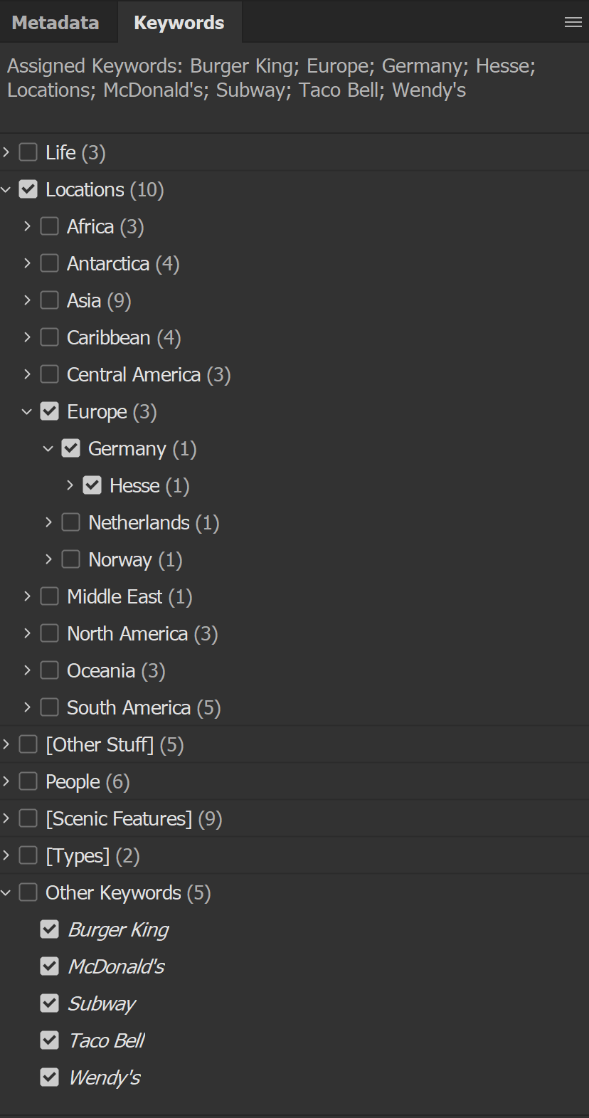

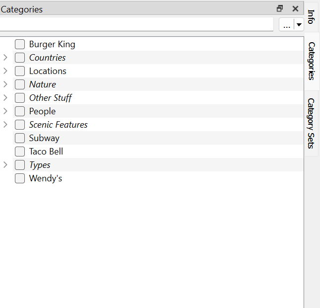

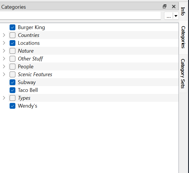

OK - I attached photos - hopefully it will make more sense

ok, so a way to not automatically import and CREATE categories from files into categories tree. And in case of categories not in the categories tree, add them in 'Others Categories', right?

Yes! And the "Other Categories" should be discarded once you close XNView (but the information is still saved in the photo).
And also re-read the photo's keywords when you select the photo even if it's in the database already.

- Posts: 2871
Re: Temporary Categories / Keywords
no need to change anything
Categories pane must always show all imported keywords as this is the only one place where you can see all cataloged keywords (not in Catalog filter). Bridge is bad example for this case as it has simple keywords management system w/o "sets/groups", check Lightroom or Capture One.
use Category Sets pane:
1. create your Set
2. add any Keywords there
3. use it
@xnview
need to create "Default" Set and add all default Categories there to make it clearer how it works
1. create your Set
3. use it
@xnview

I'll have to disagree.
If you have 100 photos tagged to 100 different restaurants, do you want to see a list of 100 restaurant names listed in the category pane even though you won't use those restaurant names again? How about 1000?

- Posts: 2871
Whether you like it or not, this is how the app should work by design.
Categories pane must show all Keywords from Catalog, 100 or 1000 it does not matter.
You have to use Category Sets to organize them.
ps: if you do not need autoimport of Keywords - disable in Settings>Metadata

Like I said - we disagree and I think you're wrong. Category panel will become unmanageable. Most photographers will agree. But whatever. I'll keep using Bridge / Lightroom unless some other app has a better combined solution.
