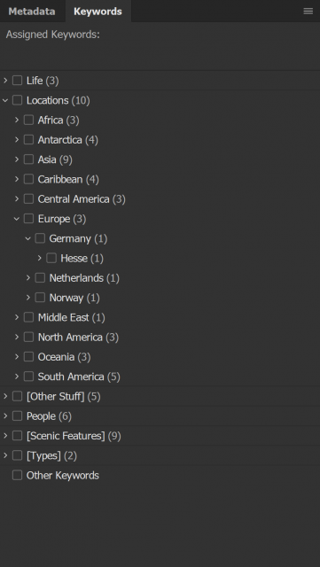

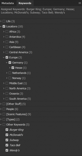

How Bridge handles it:
Europe
-> France
-> Paris
-> Germany
Other Keywords:
Munich
Restaurant 1
City 2
Restaurant 2
City 3
Restaurant 2
City 4... etc
If I close Bridge and open it again, all I will see is:
Europe
-> France
-> Paris
-> Germany
The keywords Munich and Restaurant is still in Photo 1's XMP and IPTC. Just not in the Category tree.

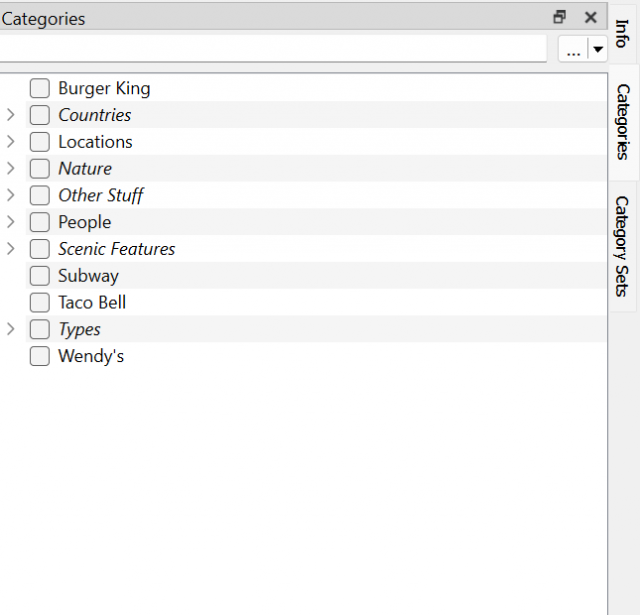

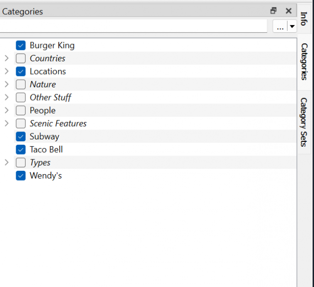

OK - I attached photos - hopefully it will make more sense

- Posts: 3196
Re: Temporary Categories / Keywords
no need to change anything
Categories pane must always show all imported keywords as this is the only one place where you can see all cataloged keywords (not in Catalog filter). Bridge is bad example for this case as it has simple keywords management system w/o "sets/groups", check Lightroom or Capture One.
use Category Sets pane:
