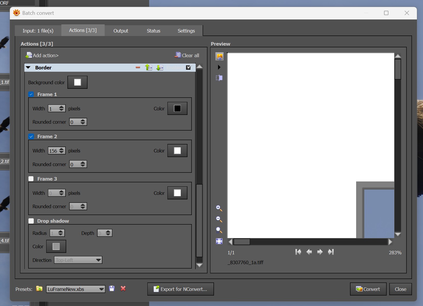

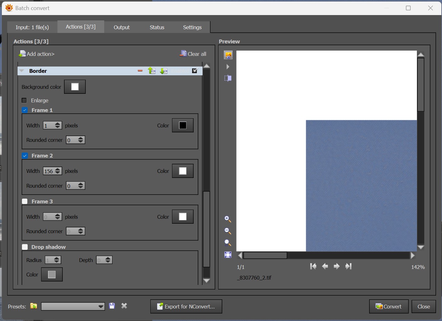

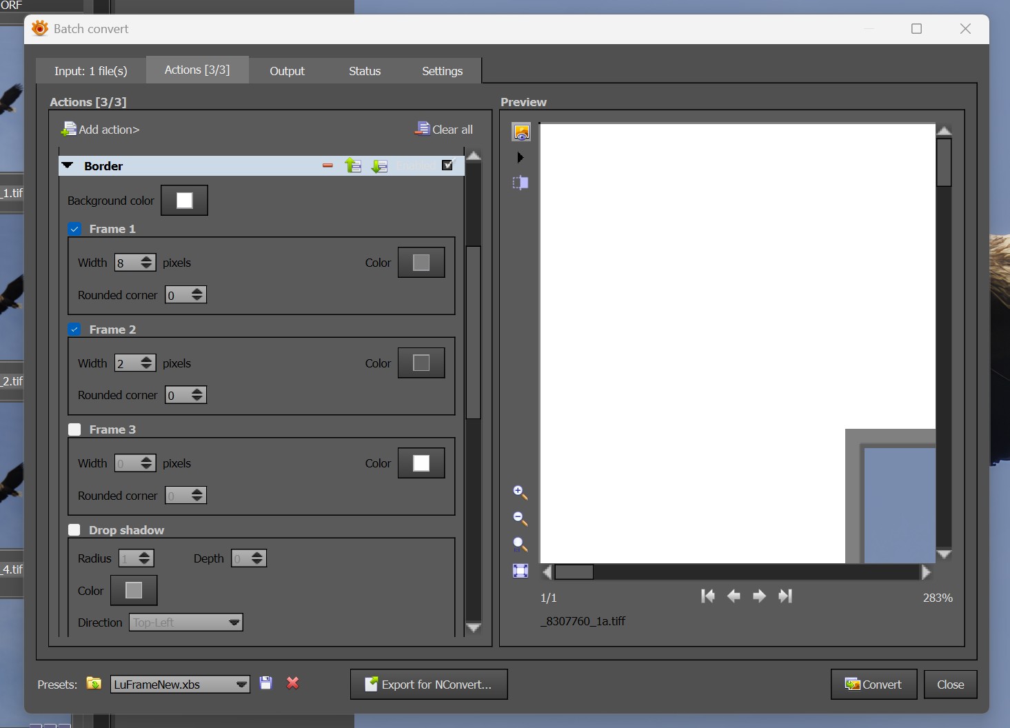

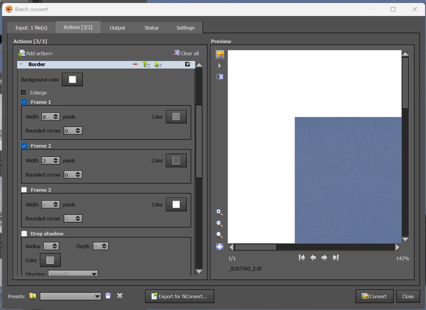

since Version 1.8.4 the "Border" action of "Batch convert ..." does not work correct!
Please, have a look at the attached screenshots for details.
There is a resize action before but that doesn't affect the generated border/frame.
Do you need further information?
Best regards
Ludger
P.S. Forgot to say ... Environment is Windows 11!
Version 1.8.3:
Version 1.8.5:

Enclosed I supply a test file for you coming together with the results of the convertion once processed with 1.8.3 and once with 1.8.6. There is also the parameter file (as a 7z archive)... I hope you can reproduce the problem.
À bientôt
Ludger
