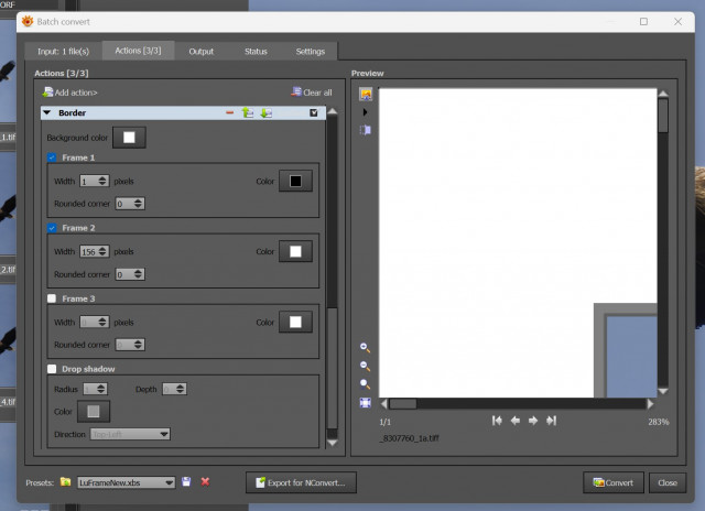

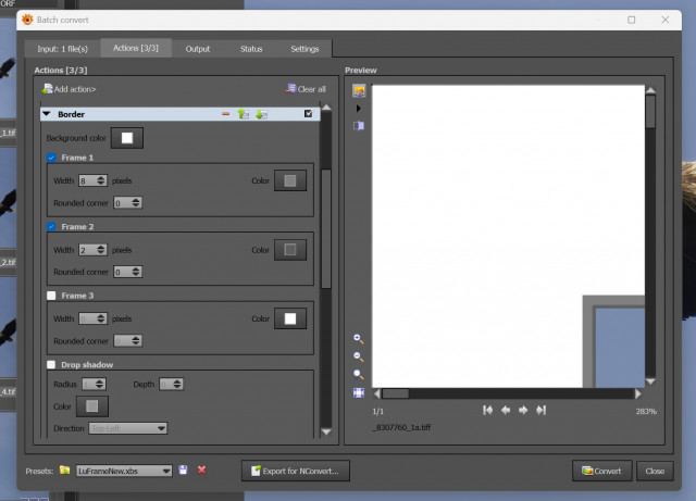

since Version 1.8.4 the "Border" action of "Batch convert ..." does not work correct!
Please, have a look at the attached screenshots for details.
There is a resize action before but that doesn't affect the generated border/frame.
Do you need further information?
Best regards
Ludger
P.S. Forgot to say ... Environment is Windows 11!
Version 1.8.3:
Version 1.8.5:

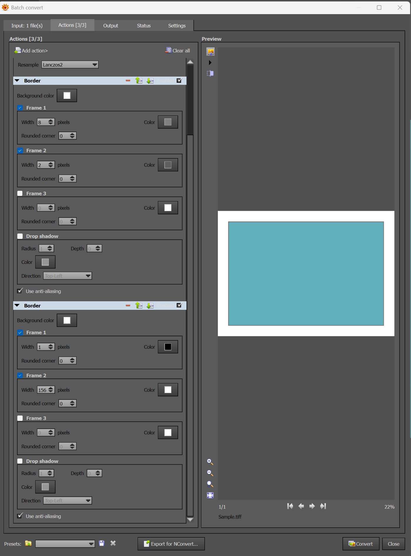

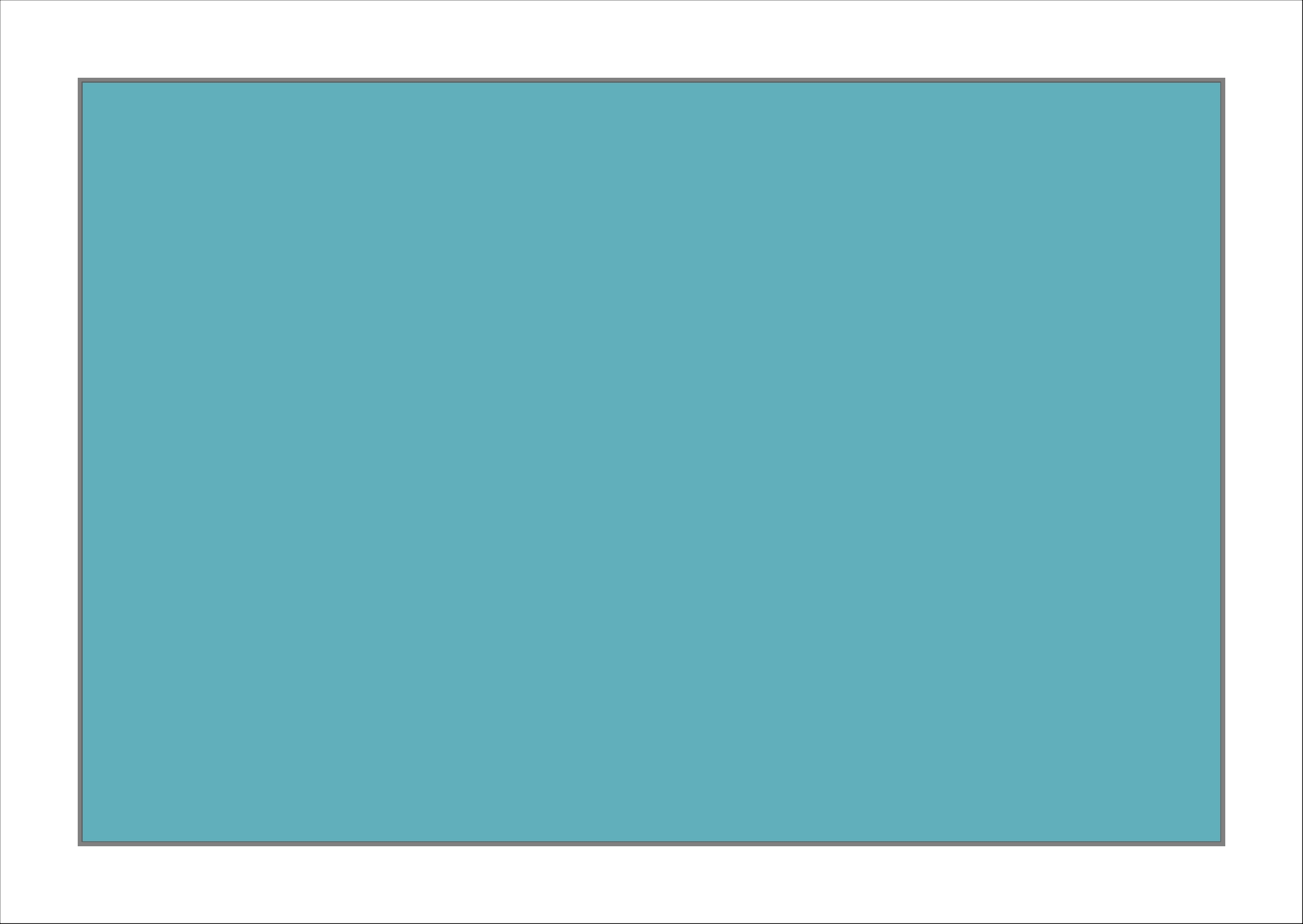

Bonjour!
thank's for having a look at this ...
Enclosed I supply a test file for you coming together with the results of the convertion once processed with 1.8.3 and once with 1.8.6. There is also the parameter file (as a 7z archive)... I hope you can reproduce the problem.
À bientôt
Ludger
LuFrameNew.7z
(659 Bytes) Downloaded 139 times
Sample.tiff
(52.84 KiB) Downloaded 142 times

Re: 1.8.4, 1.8.5 and 1.8.6 - Action "Border" does not work correct
Post by LuNik »
... I already sent the script ... it is included in the 7z archiv!
Here it is again as a zip!

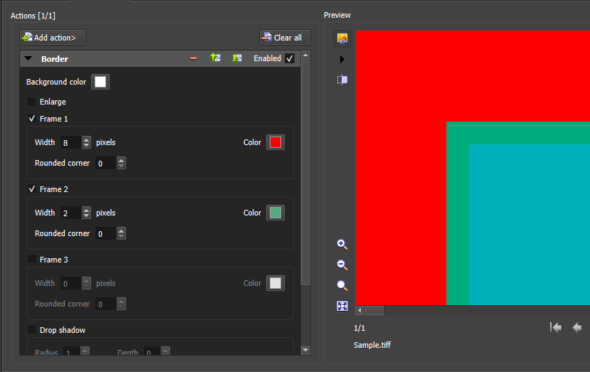

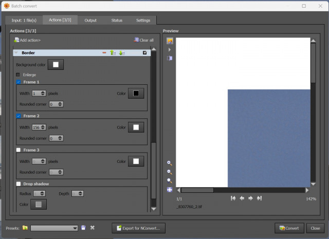

Please note that I use 2 "Border actions" with 2 frames each!!!!
I think what happens from 1.8.4. onwards is that the 1. "Border action" is skipped when there is another ""Border action".
Thanks a lot for your efforts!
Ludger
XNView Screenshot 2025-02-28 160340.jpg (219.88 KiB) Viewed 2120 times
LuNik
Posts: 38
Joined: Thu Aug 04, 2022 8:24 am
Post by LuNik »
>>> I think what happens from 1.8.4. onwards is that the 1. "Border action" is skipped when there is another ""Border action". <<<
... or somehow "overwritten" ... in 1.8.3. the 2nd "Border action was "added" to the result of the 1st "Border action" ...
Posts: 46799
you need to use 'enlarge' on second border action

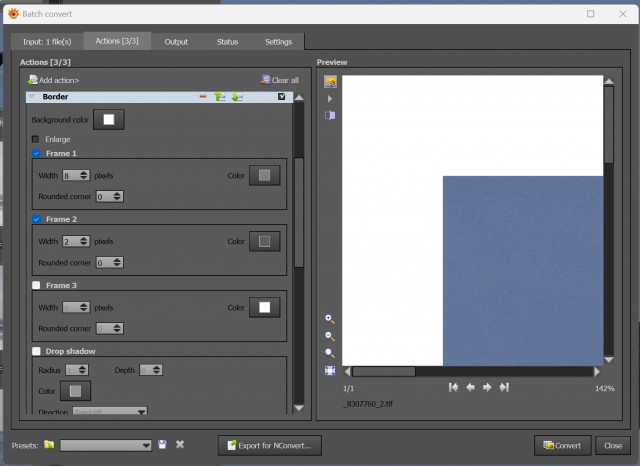

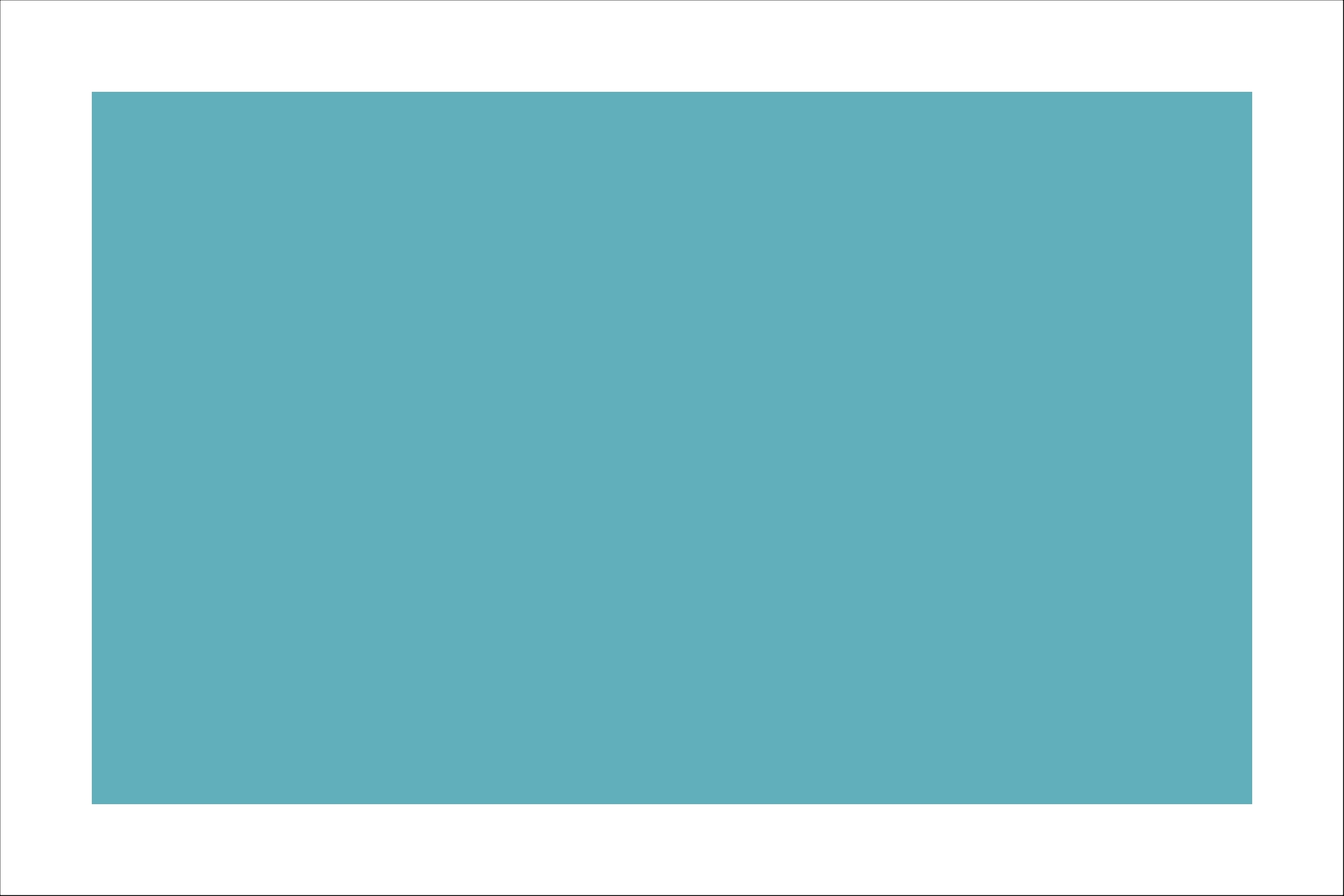

LuNik
Posts: 38
Post by LuNik »

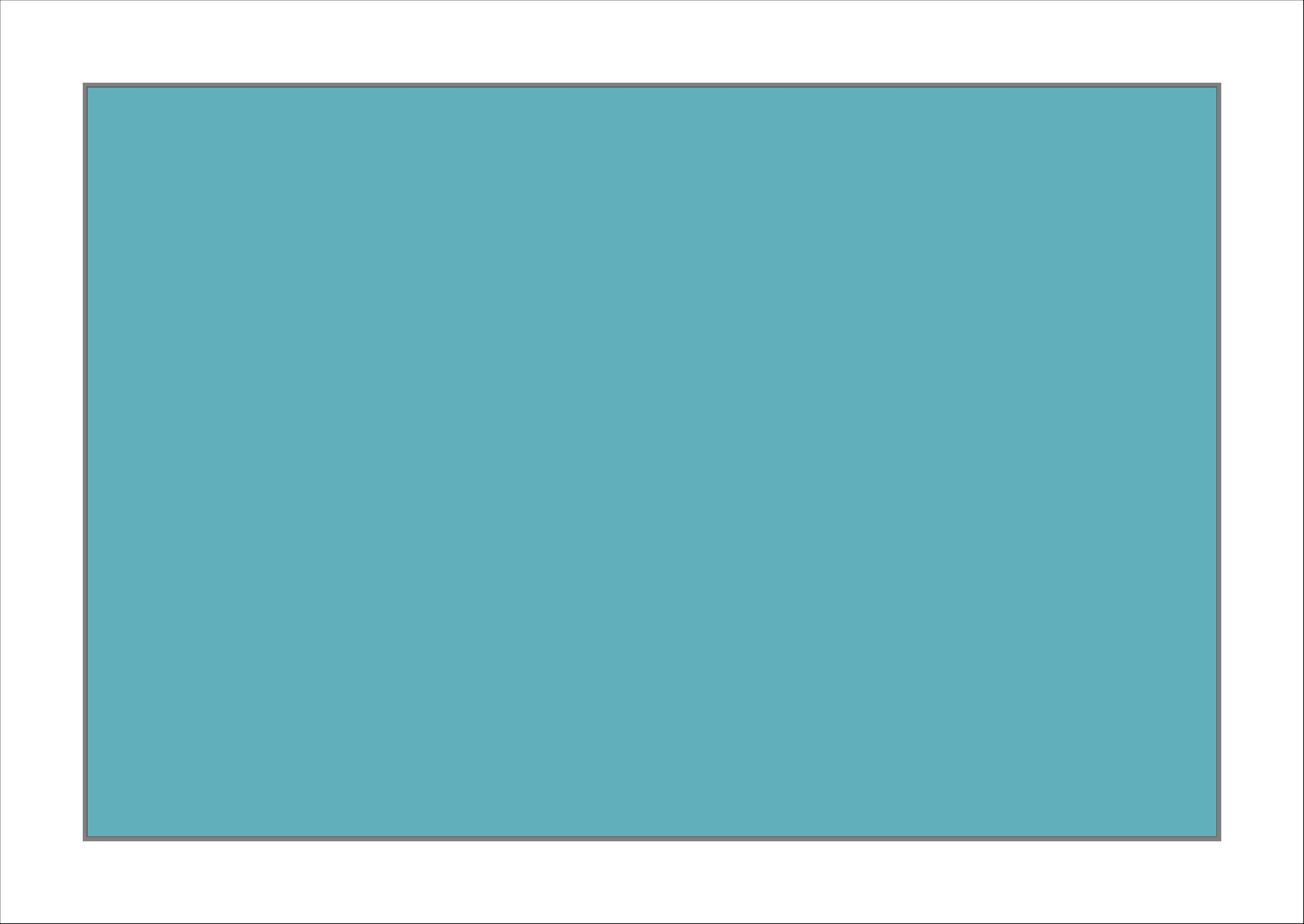

Bonjour Pierre,
just using "enlarge" doesn't give the same result as using this with version 1.8.3.!
The processed image is then 20 pixels smaler in each dimension (in this example 2612x1846 with 1.8.6. vs. 2632x1866 with 1.8.3. ...
Changing the 4th border to 166px results in the same size as before but the turquoise "photo" seems to be smaller!!! I must get a tool to mease the exact amount of pixels. Please check the enclosed jpg files!
The algorythm seems to be somehow different. I depend on getting the same results as before because I want the photos in my flickr gallery all having the same border!
Best regards
Ludger
Sample_Converted_186-with frame 4 set to166px.jpg (86.88 KiB) Viewed 2083 times

Bonjour Pierre,
it works when I use "enlarge" for both "Border actions"!
Seems that the "enlarge" option was introduced with 1.8.4. ...
So this is resolved. Thanks very much for your support!
