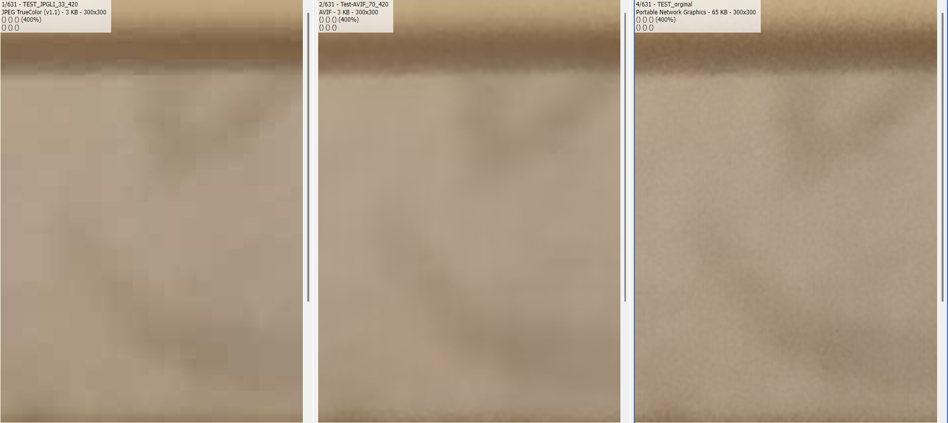

golemus wrote: Tue Feb 25, 2025 2:52 pm 35% is not enough gains that I would see sense of going through the effort of converting the collection. I will check it out anyway. So does it output standard jpeg?
If you want profits greater than 35%, you need to know what you lose. In the picture below you have on the right a test image PNG; in the middle AVIF with 70% quality; and for the same file size, on the left there is an image in JPEGLI with 33% quality. When watching in 100% zoom comparison is not bad, the copies are quite similar to the original. But what do we see after increasing to 400%? AVIF has completely lost noise/granularity. JPEGLI, like JPEG, also blurred the picture, but also clearly you can see squares.
You will receive distortions, wanting saving too much space. However, from this two evil, I will choose AVIF.
If you want to keep photography nuances, buy a larger disk and compress (or not) it to JXL not less than with 95% quality. Soon all software will be known jxl format.

Sorry, I did not answer.
My prefered settings for JPEG-LI are:
tld wrote: Tue Jul 15, 2025 5:14 am
masterjp wrote: Tue Feb 25, 2025 6:35 pm Here are my recommend settings for JPEG-LI encoding:
Can You post it in bester quality?
I can Not recognize the settings
